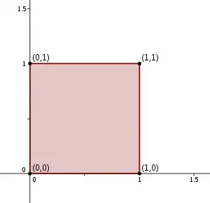

The determinant of a matrix is the scale factor by which the transformation changes the $n$-volume of the unit $n$-cube. In the $2\times 2$ case notice that $f$ (i.e. the matrix $\pmatrix{a & c \\ b & d}$) maps the $4$ vertices of the unit square -- $(0,0)$, $(1,0)$, $(1,1)$, $(0,1)$ -- to the new points $(0,0)$, $(a,b)$, $(a+c,b+d)$, $(c,d)$. You can confirm for yourself that the area of the quadrilateral with these new vertices is $ad-bc$.

So why does the reciprocal of the determinant show up in the inverse matrix? Well remember what the inverse matrix is -- it's the matrix $A^{-1}$ such that $AA^{-1} = I = A^{-1}A$. So when you multiply the matrix by its inverse you should get the identity matrix. Or using our intuition about matrices just being a way to represent linear transformations, we can say that the inverse matrix represents the function $f^{-1}$ which when composed with our original function $f$ gives the identity function. So then, if $f$ scales the unit square by $ad-bc$, then the inverse function must scale by $\frac{1}{ad-bc}$ so that when they're composed they cancel out.
