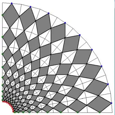

Around a circular cylinder
The $9\times 9$ computational grid with Varignon parallelograms is shown.
Boundary conditions are as follows: $$ \begin{cases} \color{red}{\mbox{inner circle impermeable:}} & (\vec{w}\cdot\vec{AB}) = 0 \\ \color{blue}{\mbox{outer circle uniform flow:}} & u = 1 \\ \color{green}{\mbox{inflow opening left:}} & v = 0 \\ \color{green}{\mbox{line of symmetry bottom:}} & v = 0 \end{cases} $$ The curvilinear grid is topologically equivalent with a $\mbox{NDX}\times\mbox{NDY}$ rectangular grid (with $\mbox{NDX}=\mbox{NDY}=9$).
Let's make a count of the unknowns and the equations and see if there is a match. First the unknowns: $$ \mbox{# velocities } (u,v) = 2\times\left[\mbox{NDX}(\mbox{NDY}+1)+\mbox{NDY}(\mbox{NDX}+1)\right] \quad \Longrightarrow \\ \mbox{# unknowns} = 4\times\mbox{NDX}\times\mbox{NDY}+2\times\mbox{NDX}+2\times\mbox{NDY} $$ Second the equations: $$\begin{cases} \mbox{# incompressible + irrotational} = 2\times \mbox{NDX}\times\mbox{NDY} \\ \mbox{# boundary conditions} = 2\times \left[\mbox{NDX}+\mbox{NDY}\right]\end{cases} \quad \Longrightarrow \\ \mbox{# equations} = 2\times\mbox{NDX}\times\mbox{NDY}+2\times\mbox{NDX}+2\times\mbox{NDY} $$ Therefore $2\times\mbox{NDX}\times\mbox{NDY}$ equations are missing. Did we forget something? Yes we did!
Remember the coordinates of the Varignon parallelogram: $$ (x_1,y_1) = \frac{\vec{A}+\vec{C}}{2} \quad ; \quad (x_2,y_2) = \frac{\vec{B}+\vec{D}}{2} \quad ; \quad (x_3,y_3) = \frac{\vec{A}+\vec{B}}{2} \quad ; \quad (x_4,y_4) = \frac{\vec{C}+\vec{D}}{2} $$ However, the above does not hold only for the coordinates; it holds for any function $T$ at the parallelogram. This phenomenon is known in Finite Element circles as isoparametrics: $$ T_1 = \frac{T_A+T_C}{2} \quad ; \quad T_2 = \frac{T_B+T_D}{2} \quad ; \quad T_3 = \frac{T_A+T_B}{2} \quad ; \quad T_4 = \frac{T_C+T_D}{2} $$ Herefrom we easily conclude, quite in general: $$ \frac{T_A+T_B+T_C+T_D}{2} = T_1 + T_2 = T_3 + T_4 $$ for any function $T$, in particular for the coordinates, but also for the velocity components $(u,v)$ : $$ u_1 + u_2 = u_3 + u_4 \quad ; \quad v_1 + v_2 = v_3 + v_4 $$ So here we are! The isoparametrics is giving us exactly the $2\times\mbox{NDX}\times\mbox{NDY}$ equations that we were missing. We end up with $N$ independent linear equations with $N$ unknowns (: $N = 360$).
