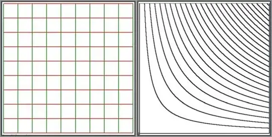

The BONUS part in the following answer shall be used as a template:
The given numerical velocity field from that template is displayed here again for convenience:
There are many roads to Rome. Talking about a given numerical velocity field, what do you mean? Among the many possibilities, there is a rectangular grid $(i,j)$ with velocities $(u,v)$ given at the vertices of the rectangles in the grid. Using ideal flow in a corner as the template, then we have for coordinates $(x,y)$ and velocities (see picture below): $$ x = i \quad ; \quad y = j \quad ; \quad u = x \quad ; \quad v = -y $$ The stream function $\psi(x,y)$ in general can be calculated with: $$ \color{red}{\frac{\partial \psi}{\partial x} = -v} \quad ; \quad \color{green}{\frac{\partial \psi}{\partial y} = +u} $$ Colors indicate that $\color{red}{horizontal}$ line segments shall be used for discretization of the first equation and $\color{green}{vertical}$ line segments shall be used for discretization of the second equation: $$ \color{red}{\psi_{i+1,j}-\psi_{i,j} = -j} \quad ; \quad \color{green}{\psi_{i,j+1}-\psi_{i,j} = +i} $$ Resulting in an overdetermined system of linear equations: $M$ equations with $N$ unknowns, where in our case

Note that $\,0 \le i,j \le \mbox{grid}-1$ . With help of a function $\;\operatorname{nr}(i,j) = j\times\mbox{grid}+i\;$ we have: $$ A_{k,\operatorname{nr}(i,j)} = -1 \quad \mbox{and} \quad \begin{cases} \color{red}{A_{k,\operatorname{nr}(i+1,j)} = +1} & \color{red}{r_k = -j} \\ \color{green}{A_{k,\operatorname{nr}(i,j+1)} = +1} & \color{green}{r_k = +i} \end{cases} $$ These equations can be assembled in a Least Squares (Finite Element) sense. Ipse est (i.e.) form the system matrix $\,S\,$ and the load vector $\,b\,$ by: $$ S = A^T A \quad ; \quad b = A^T r $$ Oh yeah, and don't forget to impose a boundary condition on the stream function somewhere. I did it at $\;\psi(\operatorname{nr}(0,\mbox{grid}-1)=0$ , by making the corresponding system matrix main diagonal element really BIG.
Now solve the equations $S\psi = b$ . Then what we get is a discretized stream function $\,\psi(x,y)$ .
The isolines of $\,\psi\,$ are the streamlines and can be plotted as shown in the above picture on the right. A bilinear interpolation at the rectangles in the grid is being employed for that purpose.
The software accomplishing all this is available for free, but it is far from optimal : take a look at MSE publications / references in 2016 . I hope you can generalize for your own purpose where such is needed. But again, there are many roads that lead to Rome, especially in Numerical Analysis.

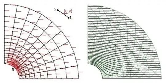

    I would like to present another example, more Finite Element like, for the sheer purpose of demonstrating the power of the Least Squares method for unstructured grids.
So there are two reasons for devising a second answer. Ideal flow past a circular cylinder (called Potential flow around a circular cylinder in Wikipedia) has been selected as the demonstration problem here and now:
Instead of taking mean values, known velocities are evaluated at the midpoints of the line segments, as is shown in the picture on the left: $$ u_{12} = u\left(\frac{x_1+x_2}{2},\frac{y_1+y_2}{2}\right) \quad ; \quad v_{12} = v\left(\frac{x_1+x_2}{2},\frac{y_1+y_2}{2}\right) $$ $$ d\psi = -v\,dx + u\,dy \quad \Longrightarrow \quad \int_{(1)}^{(2)} d\psi = -\int_{(1)}^{(2)}v\, dx + \int_{(1)}^{(2)}u\, dy \quad \Longrightarrow \\ \psi_2-\psi_1 = -v_{12}(x_2-x_1) + u_{12}(y_2-y_1) \quad \mbox{: numerically} $$ Velocity and stream function values are given by Wikipedia in polar coordinates. Which must be converted into Cartesian coordinates for our purpose. The velocities are input for the program, the stream function is for comparison of the numerical outcome with the exact solution eventually: $$ \begin{cases} V_{r}=\left(1-{R^{2}/r^{2}}\right)\cos(\theta)\\ V_{\theta}=-\left(1+R^{2}/r^{2}\right)\sin(\theta)\end{cases} \quad \Longrightarrow \\ \begin{cases} u(x,y) = \left[1-R^2(x^2-y^2)/(x^2+y^2)^2\right]\\ v(x,y) = -R^2.2xy/(x^2+y^2)^2\end{cases}\\ \psi =\left(r-\frac{R^2}{r}\right)\sin(\theta) = \left(1-\frac{R^2}{x^2+y^2}\right)y $$ Another unsatisfactory issue in the first answer is inefficiency of the code in space & time: too many zeroes are stored and there is a lot of computation with those zeroes. This can be greatly improved. There are two main stages involved with the final equations: assembly and solving.

There is still another issue with the streamline (= streamfunction isoline) plot, as shown in the above picture on the right. Solving for the parameters of a Quadrilateral Interpolation, as would be needed with the algorithm for defining an isoline plot, is virtually impossible with quadrilaterals that are not paralellograms. Therefore we have subdivided each of our quads into four triangles. Thanks to an algorithm by Paul Bourke, defining isolines with triangles is a matter of routine.
The end-result is shown in the above picture on the right. Needless to say that there is a match with the exact solution for the streamline function.
