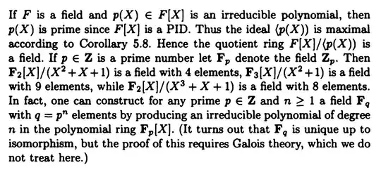

I don't understand the three claims that some $F_a[X]/(p(x))$ has some $n$ elements in the following text (from Adkins' Algebra):
For example Why $F_2[X]/(X^2+X+1)$ has $4$ elements and what are those? I think that since $(X^2+X+1)$ is an ideal so $F_2[X]={\{X^2+X+1}\}F_2[X]=(X^2+X+1)$ so $F_2[X]/(X^2+X+1)$ is singleton?
Same as the other two: Why $F_3[X]/(X^2+1)$ (or $F_2[X]/(X^3+X+1)$) has $9$ (or $8$) elements and what are those?

  • $\mathbb{F}_2[X]/(X^2+X+1)$ has the four elements ${0,1,X,X+1}$. All other elements can be reduced to one of these. – Michael Burr Nov 03 '16 at 02:24

Hint: What $R=\mathbb{F}_2/(X^2+X+1)$ means that $X^2+X+1=0$ in $R$. Therefore, any time that you see a power of $X$, you can reduce it to a lower power using $X^2=-X-1=X+1$ (we can drop the negatives since $-1=1$ in characteristic $2$).
For example, $$ X^3\equiv X(X+1)=X^2+X\equiv (X+1)+X=2X+1=1. $$

Since $x^2+x+1$ is irreducible (it is quadratic and has no root), $F_2/\langle x^2+x+1\rangle$ is a field. We can "mod out" any polynomials of degree $2$ or higher, so the only possibilities are $0,1,x,$ and $x+1$.
For example, $x(x+1)=x^2+x$, but since $x^2+x+1=0$, $x^2+x=-1=1$, so $x(x+1)=1$.
