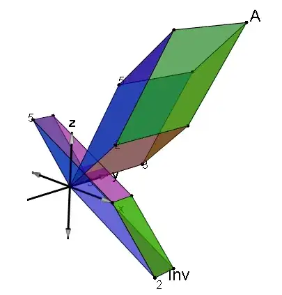

In the question Geometric interpretations of matrix inverses, I provided a visual answer for the $2 \times 2$ case, showing the relationship between the matrices $A$ and $A^{-1}$ in terms of the size and shapes of the parallelograms of their row vectors.
I've completed a parallel demonstration for the inverse of a $3 \times 3$ matrix, shown below, but I would like to characterize the relationship more completely than I did before. For example,
  • What is a general statement of the orthogonality relations between the (row) vectors $a_1$, $a_2$, and $a_3$ that define the paralellepiped of $A$ to the corresponding vectors $a^1$, $a^2$, and $a^3$ of $A^{-1}$?
  • Are there interesting relations between dot (inner) products and cross-products of the vectors $a_i$ and $a^i$?
  • How can one describe the relationships between the faces of $A$ and $A^{-1}$?
In this example, I use the following matrix A, whose determinant is 2.

Here is a 3D plot of $A$ and $A^{-1}$, with axes and some corresponding vertex points labeled. Faces are colored in the same way on both views.
Here is an animated version of the same, rotating around the $z$ axis.
In case anyone is interested, these figures are done in R, and the code for this example is in this gist
