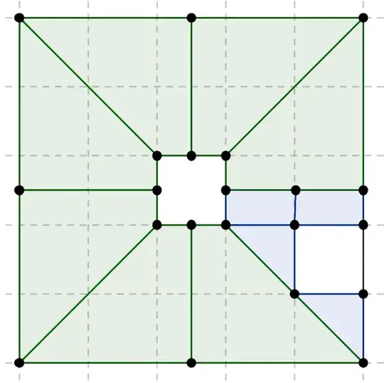

Consider a $n\times n$ grid minus the central square. You may divide such "square annulus" in eight parts with the same area, in such a way that each part has an even number of halved (horizontally, vertically or diagonally) squares, so the area of each part is an integer.
