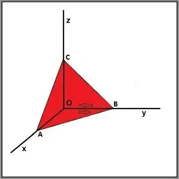

A simpler approach is via integral theorems. As stated in the question, the special cases for a rectangle in the $xy$ , $yz$ , $zx$ planes are well understood. According to Green's theorem : $$ \begin{cases} \iint_{xy} \left(\frac{\partial F_y}{\partial x} - \frac{\partial F_x}{\partial y}\right) dx\, dy = \oint_{xy} \left( F_x\, dx + F_y\, dy \right) \\ \iint_{yz} \left(\frac{\partial F_z}{\partial y} - \frac{\partial F_y}{\partial z}\right) dy\, dz = \oint_{xy} \left( F_y\, dy + F_z\, dz \right) \\ \iint_{zx} \left(\frac{\partial F_x}{\partial z} - \frac{\partial F_z}{\partial x}\right) dz\, dx = \oint_{xy} \left( F_z\, dz + F_x\, dx \right) \end{cases} $$ But instead of rectangles, we take half rectangles, or better: the triangles $OAB$ , $OBC$ , $OAC$ respectively:
Thanks to Green's theorem we can replace area integrals by line-integrals; mind that they are counter-clockwise. Then it is clear that, irrespective of any further content: $$ \oint_{OAB} + \oint_{OBC} + \oint_{OAC} + \oint_{ABC} = 0 $$ Assuming that the operator rot(ation) is not defined yet in general, this means that we now have an expression for it: $$ 2 \iint_{ABC} \vec{\operatorname{rot}}(\vec{F}) \cdot \vec{n}\, dA = \\ - \iint_{xy} \left(\frac{\partial F_y}{\partial x} - \frac{\partial F_x}{\partial y}\right) dx\, dy - \iint_{yz} \left(\frac{\partial F_z}{\partial y} - \frac{\partial F_y}{\partial z}\right) dy\, dz - \iint_{zx} \left(\frac{\partial F_x}{\partial z} - \frac{\partial F_z}{\partial x}\right) dz\, dx $$ Continuing with infinitesimal volumes / areas and flipping normals on the right hand side, so that they become the components of the normal at the left hand side: $$ \vec{\operatorname{rot}}(\vec{F}) \cdot \vec{n}\, \Delta A = \\ \left(\frac{\partial F_z}{\partial y} - \frac{\partial F_y}{\partial z}\right)\cdot n_x\, \Delta A + \left(\frac{\partial F_x}{\partial z} - \frac{\partial F_z}{\partial x}\right)\cdot n_y\, \Delta A + \left(\frac{\partial F_y}{\partial x} - \frac{\partial F_x}{\partial y}\right)\cdot n_z\, \Delta A $$ Leaving out the infinitesimal area $\,\Delta A\,$ gives us the same answer as found by the OP themselves.
A somewhat neater approach is to calculate mean values and let the area of the (red) triangle go to zero: $$ \vec{\operatorname{rot}}(\vec{F}) \cdot \vec{n} = \lim_{ABC \to 0} \frac{\iint_{ABC} \vec{\operatorname{rot}}(\vec{F}) \cdot \vec{n}\, dA}{\iint_{ABC} dA} $$ Note. I've encountered essentially the same method at several places elsewhere in physics (I think it's with stress and strain). Aanyway, a related subject is : What does shear mean?

  • Great answer! This is the same approach taken here http://file.scirp.org/pdf/APM20120100008_94595561.pdf no? I decided to go with rectangle loops because it is possible to rigorously prove Stroke's theorem using Riemann sums if we prove the density limit for rectangle loops. The problem with triangles for me is that there is a fundamental restriction on the triangle forms for each plane and it's harder to prove that the surface can be appropriately triangulated. – Veritas Sep 29 '16 at 21:37
  • Yes, I think that publication reflects some essentials of the method. But what physicists usually do is: simply delete the volume integral signs by an "infinitesimal" argument, as is shown in my last step. Being a physicist by education myself, I find this sufficient rigor already; mathematicians may have a different opinion about it. Though it employs triangles, yet I don't think my argument has anything to do with "triangulation". – Han de Bruijn Sep 30 '16 at 13:46
