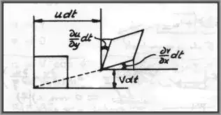

But let's concentrate now on the shear (or distortion) part, as requested by the OP. Consider one of the terms, take $\large \frac{1}{2}\left(\frac{\partial v}{\partial x} + \frac{\partial u}{\partial y}\right)$ , in two dimensions for simplicity.
During a time $dt$ a (square) fluid particle is transported in the plane. Then $\large \left(\frac{\partial v}{\partial x} + \frac{\partial u}{\partial y}\right)$ is the velocity of the change of the two angles, as shown in the picture. (Also notice that the angles, say $\phi$ , are very small, so $\,\tan(\phi) \approx \phi$ ) The fluid particle is deformed herewith. Therefore the symmetric (traceless) matrix is also known as a deformation tensor. The deformation tensor contains half the velocities of the deformation of a fluid particle.

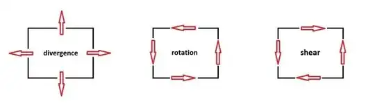

by employing Green's theorem : $$ \iint \left( \frac{\partial M}{\partial x} - \frac{\partial L}{\partial y} \right) dx\,dy = \oint \left( L\,dx + M\,dy \right) $$ When specified for our three special cases, it reads: $$ \begin{cases} \mbox{divergence :} & \large \iint \left( \frac{\partial u}{\partial x} + \frac{\partial v}{\partial y} \right) dx\,dy = \oint \left( -v \,dx + u \,dy \right) \\ \mbox{curl :} & \large \iint \left( \frac{\partial v}{\partial x} - \frac{\partial u}{\partial y} \right) dx\,dy = \oint \left( u \,dx + v \,dy \right) \\ \mbox{shear : } & \large \iint \left( \frac{\partial v}{\partial x} + \frac{\partial u}{\partial y} \right) dx\,dy = \oint \left( - u \,dx + v \,dy \right) \end{cases} $$ A picture says more than a thousand words:
Working out the shear part separately - performing vector addition $\,(\pm u,\pm v)\,dt\,$ - results in: enter image description here
