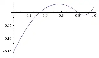

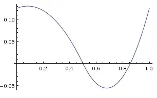

There is no dominant strategy. For any strategy $H_a$ you can find strategies that are better, and strategies that are worse. To get a better a sense have a look at the following two graphs. They show the gain of two strategies $H_{0.5}$ and $H_{0.8}$ against any possible strategy.
The $x$ axis on both graphs is just the parameter $a$ going from $0$ to $1$ while the $y$ axis is $G(H_{0.5}, H_a)$ for the graph on the left and $G(H_{0.8}, H_a)$ for the graph on the right.
Gain for H_0.5 Gain for H_0.8
You can notice for example that $H_{0.5}$ is better than $H_{0.2}$, $H_{0.8}$ is better than $H_{0.5}$, but $H_{0.2}$ is better than $H_{0.8}$.
