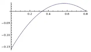

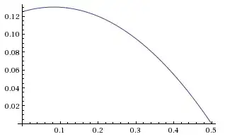

Let's try to get some insight by restricting the formula a bit. Let's take $x=1$ and set $b$ to a couple different values. Here are two graphs for $b=0.5$ and $b=0.8$ The vertical axis shows the gain, while the horizontal axis is the parameter $a$ of the opponent strategy $H_{a}$ with $a \in [0, b]$
H_0.5 vs H_a, 0 < a < 0.5 H_0.8 vs H_a, 0 < a < 0.8
These are parabolas as we expected by looking at the formula. They all have an obvious root at $a=b$. In other words, it is obvious that we should get zero gain if a strategy is pitched against itself. The other root depends on b. Our first example ($b=0.5$), has no other root in the interval $[0, 0.5]$, making the gain positive for the whole interval. Our second example ($b=0.8$) has another root at $a=1/3$, making the gain positive only in $[1/3, 0.8]$ We can find the roots to the general gain expression above. The interval between the roots is where the gain is positive. Using the automated equation solver at quickmath.com I found the roots to the general expression: $$a=b$$ $$a=-\frac{2x(b-1)+b}{b-2}$$

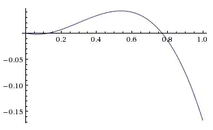

Here's how $\widehat G_{a=0..1}(H_b, H_a)$ looks like for all the values of b Average gain over all possible honest opponents
$\widehat G_{a=0..1}(H_b, H_a)$ has 3 roots, at: $0, \frac{9 \pm \sqrt{41}}{20} \approx 0, \; 0.13, \; 0.77$
We can also check whether our calculations are correct. If we find the average over all average gains, this should be zero. Indeed, integrating $\widehat G$ over all b we get $0$. We notice that the gain is not uniform across $b$. This poses a game theory problem. If we had a uniform function equal to $0$ then we would know what the optimal strategy would be: each time choose randomly a number $b \in [0,1]$ and implement $H_b$. The gain would be $0$ but this strategy could not be exploited. Now with a non uniform $\widehat G$ I am not sure if there is a solution. We start by noticing that if your opponent selects $H_a$ where $a$ is uniformly selected from $[0,1]$ then there is an obvious advantage for you to pick $H_b$ where $b$ is uniformly selected from [0, 0.77]. You end up with positive gain. Could this be exploited? Could your opponent knowing that you are choosing from $[0, 0.77]$, gain by selecting only from $[0.77, 1]$. Let's find out. Calculate what is $\widehat G_{a=0..0.77}(H_b, H_a)$ for $b > 0.77$. This is what the graph looks like:

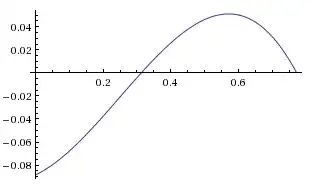

Average gain over opponents in 0-0.77
It's all negative. Seems this is a safe move. Players can choose $H_b$ where b is uniformly selected from $[0, 0.77]$. If both players do this, then the expected gain is 0. If, on the other hand, one player chooses over the whole interval $[0, 1]$ or in $[0.77, 1]$ then the other player wins.
But we can extend this move! If both players are choosing in $[0, 0.77]$ then there is a clear incentive for one player to get rid of other low-gaining regions. First let's look at the new Average gain if both players are choosing from $[0, 0.77]$ This is $\widehat G_{a=0..0.77}(H_b, H_a)$ for $b \in [0, 0.77]$ and it looks like this:
Average gain if both players choose from 0-0.77

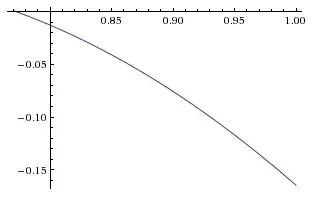

So if one player only chooses in $[0.2, 0.77]$, then they have a clear advantage over the player who chooses in $[0, 0.77]$. But is this move open to an exploit? What if the other player chooses in $[0.77, 1]$?

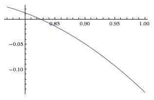

Let's calculate what is $\widehat G_{a=0.2..0.77}(H_b, H_a)$ for $b > 0.77$. This is what the graph looks like:
Average gain if opponent in 0.2-0.77 and you 0.77-1
So an exploit exist! If the other player chooses in $[0.77, 0.825]$ they have a positive gain. So we are back in these loops even with diversifying our strategies by randomly selecting the strategy parameter within an interval. This is where my game theoretic knowledge abandons me. Given this non-uniform average gain function, can we find an equilibrium, or do we declare that an equilibrium does not exist? If an equilibrium exists I suspect that it is achieved with a non-uniform selection of the strategy parameter. A selection that will in effect normalise the average gain function into a uniform one. I will actually create a question in math.stackexchange about this.
