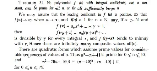

There is an alternative proof provided by Hardy in his book "An Introduction To The Theory Of Numbers", Theorem 21, page 18 enter image description here
