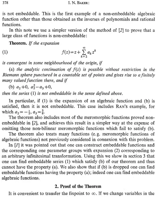

I've just looked at the 1967 article "Non-Embeddable Functions with a Fixpoint of Multiplier 1" of I.N.Baker (Math. Zeitschr. 99, 377-- 384 (1967)) and it seems, that it answers -at least to a big part- your question. The keyword "Embeddable" means here that such function can (or cannot, when "not embeddable") have an analytic/continuous iteration, which is analoguous to your question, whether/when fractional iterates have power series with nonzero convergence radius. I've just taken a screen shot of the second page of the article, perhaps this is useful:
