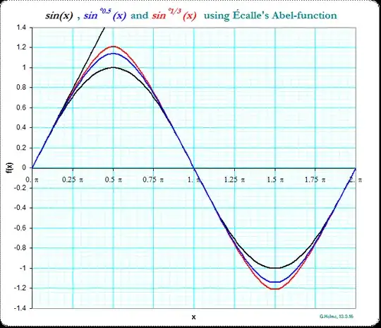

There have been a couple of questions about this function at MSE and Math Overflow, perhaps the best discussion related to your question is at MO which includes a solution via the technique of finding the Abel-function introduced by J.Ecalle.
I've looked -more naively- at the formal power series up to the 512'th term finding strong divergence here or here so concluding the radius of convergence of the power series being zero (but the series usable as asymptotic series giving usable approximations at truncations of the series, or being Noerlund-summable in the sense of summation-procedures for divergent series)
A picture of $y=\sin(x)$, the half-iterate $y=\sin^{\circ 0.5}(x)$ , $y=\sin^{\circ 1/3}(x)$ and $y=x$ (using the asymptotic powerseries of Ecalle's Abel-solution as shown in that thread at MO)
