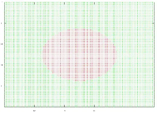

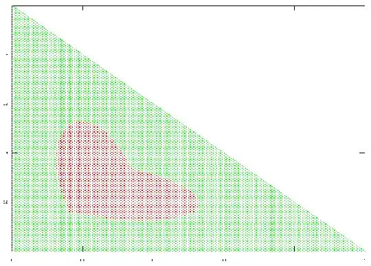

Alright, so what's the problem? This mapping makes something that kind of looks like a reentrant corner on smooth areas mapped to the simplex. For example, if we set $v=(1,\dots,1)$ and map a circle centered at $(0.5,0.5)$ of radius $0.25$ to the simplex, we go from Circle on a square to Circle on a simplex Basically, we get a heart shaped object with these hard corners. I've tried a bunch of different schemes for choosing $v$ and I keep getting corners, which is undesirable. I really want something that's mapped smoothly to the simplex.

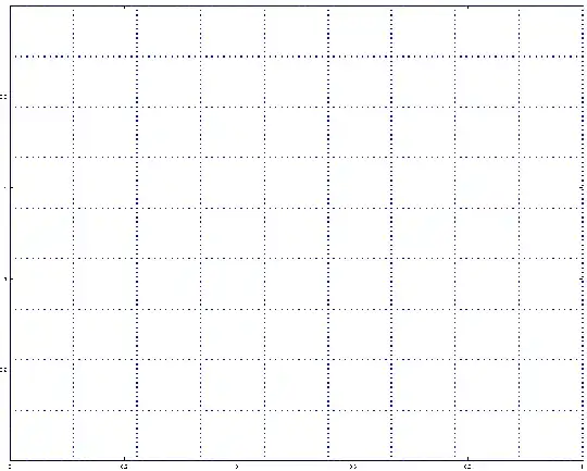

I think @Del has a good answer and here's what it looks like. Given a rectangular grid
rectangular grid

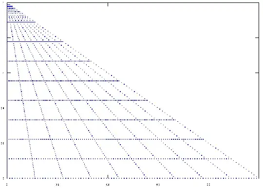

The scheme transforms this into
deformed grid

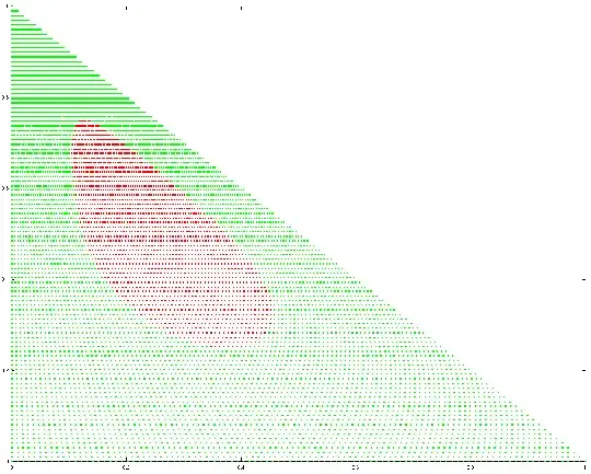

which shows how the grid is squished to fit into the simplex. It turns out this is smooth for the use case I described above. We can see this with the deformed circle
deformed circle
