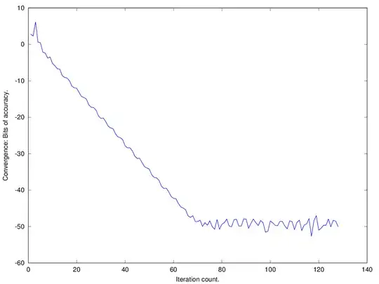

enter image description here Convergence plot in a case when $\bf C, C_2$ admit for a real solution. Notice the convergence is both exponential and stops at error of $2^{-50}$: close to the mantissa of 52 bits for double precision floats.
