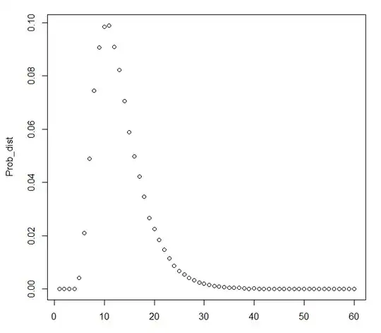

Empirically the answer to the original question seems to be near $13.2$, with the distribution of the probabilities of the number of random quadrants needed looking something like this (the first four points are the probability that one to four quadrants will cover the circle - clearly zero).

  • did the probabilities in the plot come from results in the Holst papers you referenced, or are they empirical values? – Rus May Aug 29 '12 at 19:09
  • @Rus: they are empirical values from trying 100,000 times. That shows up in the tiny bump at 39/40. – Henry Aug 29 '12 at 23:10
  • Those references look straight to the point. Sure enough, this is a well-known problem. I've read a couple papers by Lars Holst before, so I'm pretty sure I'll enjoy these, as well. Also, thank you for taking the time to make such a nice-looking plot. – Rus May Aug 30 '12 at 01:57
