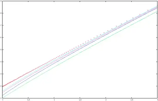

I did some exact (i.e. non-discretized) simulations; the results are in good agreement with the above expansion. The code is here. I ran $1000$ trials each for $1/20\le\mu^{-1}\le1$ in steps of $1/100$.
Here's a log-log plot of $\langle N\rangle$ over $\mu$:
log-log plot of N over mu
(You can get the full resolution by displaying the image in another tab or window.) The red crosses are the data points, and the green, blue, magenta and cyan curves respectively include successive terms of the above expansion. The fact that successive terms get increasingly close to the data seems to indicate that the unanalyzed errors are at most $O(\mu^2)$.
The estimated standard errors for the data points from the simulation are too small to display. The values and errors at different $\mu$ are strongly correlated, since the code works by successively adding raindrop centres and lowering a threshold $r$ at which drops at these centres would cover the table; but the trial runs as a whole are independent, so the error estimates are valid.

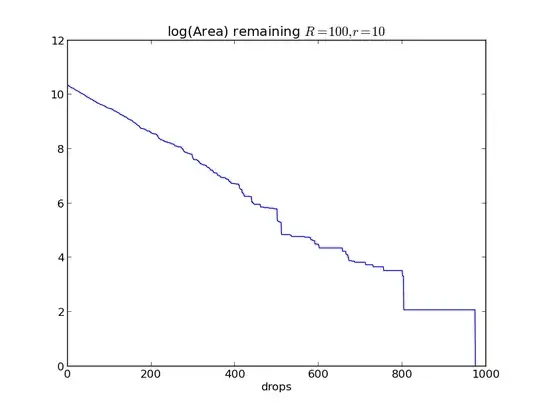

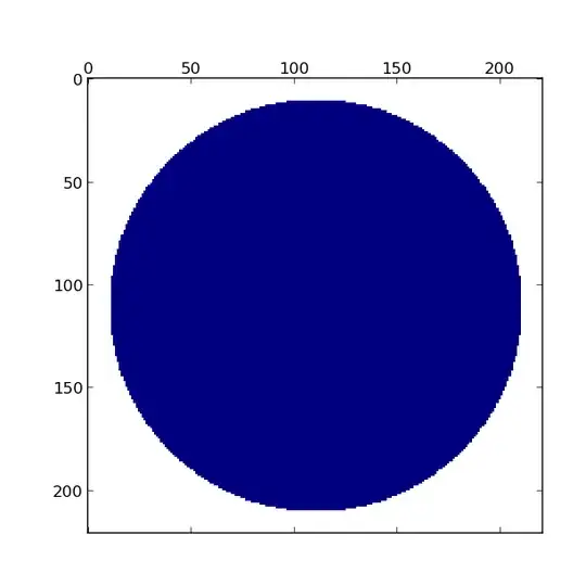

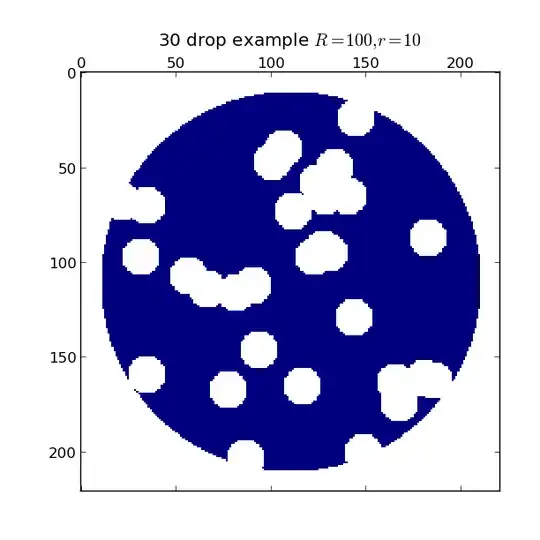

Allow me to make some discretization approximations to a circle. Define a circle of radius $r$ at location $\bf x$ as the set of all points $\bf y$ on a lattice in $\mathbb{Z}_d$ where $\|{\bf x}-{\bf y}\|_2<r$. This isn't to bad when $r \gg 1$, shown below is a 100 radius "circle":
The approximation gets worse when $r<10$, so we will limit all droplets to this size. To code up a simple Monte Carlo example we make a square area $A$ whose length is $2R + 2r$, and put a circular table in the center of radius $R$ with a positive mask. Choose points in $A$ and keep them if they are in within the radius $R$. For each selected point, subtract a circular mask of radius $r$. Continue until the circular table is empty and count the drops needed. An example of this in motion looks like:
A time-series of the log of the area remaining for an individual run:

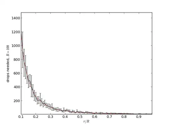

I ran 10 trials for $r \in 10..R-1$ and plotted the mean with the std dev as the error bar.
I'm at a loss to describe the function - the best fit I could come up with (which really is not fit at all) was $c \exp{(-17.9 (r/R)^{-1.6})}$. At the very least, I can say that it drops faster than an exponential.

    FWIW, it seems that a function of the form $f(r/R) = c \cdot (r/R)^{-2}$ fits your simulation of "drops needed" quite well, with $c \approx 12$ (whereas the lower bound I posted has the same form but with $c = 2 \pi / \sqrt{27} \approx 1.2$. – r.e.s. Aug 03 '12 at 00:47
  • As r.e.s. says, it seems to be consistent with the other results, and this result really verifies that we're on the right track. Thank you, Hooked! – Nicolás Kim Aug 03 '12 at 10:33
