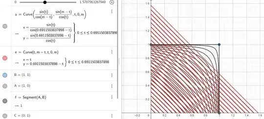

Here is a graphical answer obtained with Geogebra:
To the "sweeping" of the triangle by red line segments $R_m$ with equations $$x+y=m \ \ \text{for} \ \ 0 < m < \pi/2$$
is associated the "sweeping" of the square $[0,1]^2$ by black curves $B_m$ with parametric equations $$x(t)=\frac{\sin(t)}{\cos(m-t)}, \ \ y(t)=\frac{\sin(m-t)}{\cos(t)}$$
At bottom left, the first red lines are almost identical to their black images (indeed for small angles, formulas (1) give $x\approx\frac{u}{1}$ and $y\approx\frac{v}{1}$). Further on, the black curves, images of the red line segments, display an increasing bending.

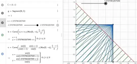

In fact two other simple sweepings are possible as illustrated in the figure below
$$y-x=n \ \ \text{for} \ \ -\pi/2 < n < \pi/2$$
in correspondence with the curves whose parametric equations are:
$$x(t)=\frac{\sin(t)}{\cos(n+t)}, \ \ y(t)=\frac{\sin(n+t)}{\cos(t)}$$
