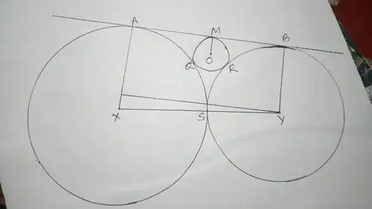

In the given figure, $X$ and $Y$ are two centres of two circles. They touch each other externally at a point $S$. $AB$ be the common tangent of both circles. $O$ be the centre of the third circle which touches the two circles at points $Q$ and $R$. If $AX=h$, $OM=f$ and $BY=g$, then prove that $$\frac {1}{\sqrt { f }}=\frac {1}{\sqrt { h }} +\frac {1}{\sqrt { g }}$$
My attempt
If we join $OA$ we have, $$f^2={OA}^2-{AM}^2=$$; using pythagoras theorem
Again if we join $OB$ then $$f^2={OB}^2-{MB}^2$$ Now how should I move further?

Hint: $BM^2=(g+f)^2-(g-f)^2=4gf$ $AM^2=(h+f)^2-(h-f)^2=4hf$ $(AM+BM)^2=(g+h)^2-(g-h)^2=4gh$
Square root both sides of all three expressions, then plug the first two expressions into the third one, and you get the final equality you need to prove.

How long is AB?
$XY = g + h$ you have a already constructed parallel to $AB$ from $Y$ to an unidentified point that I will call $Y'$
$YY' = h-g\\ (h-g)^2 + AB^2 = (h+g)^2\\ AB^2 = 4gh$
We can do a similar construction to get $BM$ and $AM$
$BM^2 = 4fg\\ AM^2 = 4fh\\ \sqrt {4fg} + \sqrt{4fh} = \sqrt{4gh}$
divide trough by $2\sqrt{fgh}$ and we get our desired result.

  • I couldn't understand your parallel concept, please clarify. – pi-π Jul 16 '16 at 09:21
  • You have constructed a line in your diagram that is parallel to AB and intersects Y, forming a narrow little right triangle. One leg is has the same length as AB, one leg has a length equal to h-g, and the hypotenuse = XY has a length equal to g+h – Doug M Jul 17 '16 at 21:46
