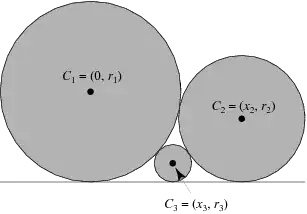

Sorry if this is a foolish question, but I'm having difficulty understanding how to solve for $r_3$ in the following diagram...
Diagram
According to WolframAlpha's page on tangent circles, the radius of $c_3$ can be calculated using the following formula $r_3=\frac{r_1 \times r_2}{(\sqrt{r_1}+\sqrt{r_2})^2}$, which can be simplified to $\frac{1}{\sqrt{r_3}}=\frac{1}{\sqrt{r_1}} + \frac{1}{\sqrt{r_2}}$.
To be completely honest, I'm having a hard time understanding understanding how this formula works (as I'm a very visual person). What exactly is happening here?

    Do you know the notion of vector product? however, you can get similar result if you use Pythagorean identity on the triangle which its sides connected between $C_{1,2,3}$ –  Dec 17 '14 at 03:54
This answer to a slightly different problem gives a useful diagram showing how to compute the distance between the points of tangency of two circles and a line, given that the circles are externally tangent (as yours are).
From this we see that if we label the three points of tangency $A,$ $B,$ and $C$ (in sequence from the leftmost such point to the rightmost in your diagram), then considering just the two circles of radius $r_1$ and $r_3$, which touch the line at $A$ and $B$,
$$ |AB| = 2\sqrt{r_1 r_3}. $$
For the other two pairs of circles we get $ |BC| = 2\sqrt{r_2 r_3} $ and $ |AC| = 2\sqrt{r_1 r_2}.$ We can also see that $ |AC| = |AB| + |BC|;$ substituting the formulas we just found for those three lengths (or perhaps even better still, labeling the three distances $ 2\sqrt{r_1 r_3},$ $ 2\sqrt{r_2 r_3},$ and $2\sqrt{r_1 r_2}$ on your diagram),
$$ 2\sqrt{r_1 r_3} + 2\sqrt{r_2 r_3} = 2\sqrt{r_1 r_2}.$$
I can't think of a visual representation of the last step, but algebraically, you can divide all three terms by $2\sqrt{r_1 r_2 r_3}$ to get
$$ \frac1{\sqrt{r_2}} + \frac1{\sqrt{r_1}} = \frac1{\sqrt{r_3}},$$
which is your simplified formula. You can then get the other formula by further algebraic manipulation.
