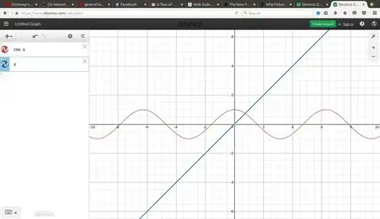

fixed point of a function taking the real numbers to the reals is a place where the graph crosses the line $y=x.$ Existence and uniqueness can be shown with ordinary calculus theorems
