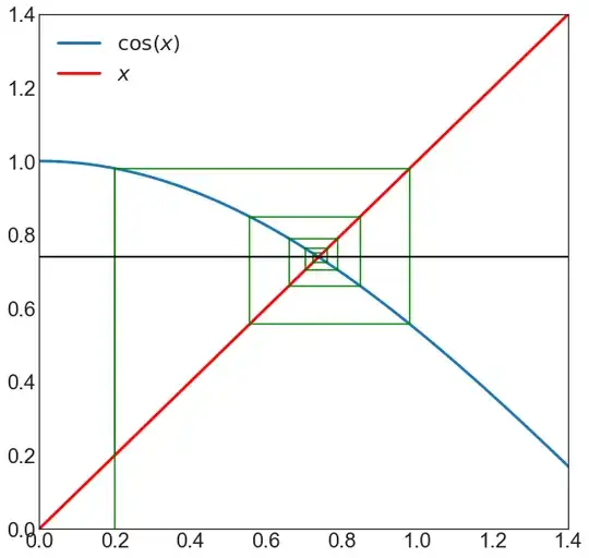

I know others have sufficiently answered your question, but I wanted to add a neat graphical representation. You can start from some particular $x$ value, go vertically to the $y=\cos(x)$ curve, then horizontally to the $y=x$ line, and repeat this process to zero in on the fixed point of $f(x)=\cos(x)$. fixed point of cosine
Here I'm starting with an initial $x$ value of $x_0=0.2$. Or alternatively, you can plot the function $f(x)=\cos\cos\cos...x$ for a large number of iterations and notice it is a nearly constant function. (I'll let you do this yourself.) As a final note this number is in fact transcendental and has a special name, the Dottie Number.
