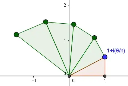

Angle $\theta$
When calculating $\left(1+\dfrac{i\theta}{n}\right)^n$ for fixed $n$ geometrically, we can draw a right triangle with vertices at $0$, $1$, and $1+\dfrac{i\theta}{n}$. Then a triangle on the hypotenuse, with a new vertex at $(1+\dfrac{i\theta}{n})^2$. Then a new triangle... This yields something that looks like n=5 theta=2.7
You can manipulate this spiral at a little geogebra applet I made.
Assuming $\theta>0$, the $k^{\text{th}}$ triangle has a leg away from the origin of length $\dfrac{\theta}{n}\left|1+\dfrac{i\theta}{n}\right|^{k-1}$. For $n$ large, the outer perimeter of this spiral is intuitively close to $\theta$ since $\left|1+\dfrac{i\theta}{n}\right|$ is very close to $1$, so each factor like $\left|1+\dfrac{i\theta}{n}\right|^{k-1}$ is fairly close to $1$, so that it is as if we are adding $n$ terms of $\dfrac{\theta}{n}$. Arguing that more formally may require calculus or clever algebra after the sum of the finite geometric series is calculated to be $\dfrac{\dfrac{\theta}{n}\left(\left|1+\dfrac{i\theta}{n}\right|^{n}-1\right)}{\left|1+\dfrac{i\theta}{n}\right|-1}$.
If $0\le\theta<2\pi$, then the perimeter approaching $\theta$ gives you an arc length, and hence an angle, of $\theta$ around the unit circle, as desired. If $\theta>2\pi$, then if we hope or check that $e^{i\theta}e^{i\rho}=e^{i(\theta+\rho)}$ with our definition, then you can get the desired angle by adding/subtracting the relevant multiple of $2\pi$, we get the desired result.

  • can you please @Mark S give a picture to the geometric construction in the argument proof. – Hamza Jun 25 '16 at 18:18
    @Hamza I have added the things you requested, plus an interactive applet to allow you to reproduce the sorts of pictures in the Mathologer video that I tried to describe. – Mark S. Jun 25 '16 at 20:29
