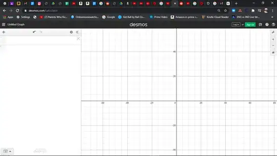

Let us begin by opening the complex plane (take the $y$ axis to be the imaginary axis and the $x$ axis to be the real axis)
A picture of the blank complex plane, I don't have enough reputation to embed pics directly, pls send help

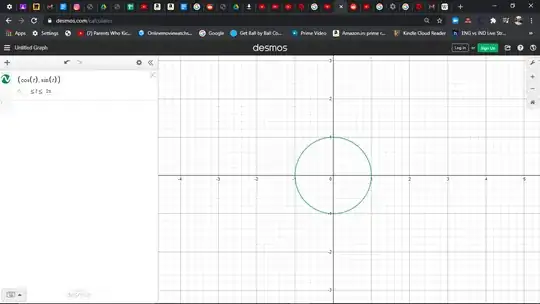

Given that you have a complex number $z = a + ib$ (where $a$ and $b$ are both members of the real numbers) $a$ will be the real part of $z$, and $b$ will be the imaginary part of $z$. We can plot $z$ using rectangular coordinates.
Given $z = \cos(t) + i\sin(t)$, $\cos(t)$ is the real part of $z$, and $\sin(t)$ is the imaginary part of $z$. We can hence parameterize the real and imaginary parts of $z$ in terms of an arbitrary parameter $t$ (which, as is customary with calculus, is measured in radians). Drawing this on the graph gives us the following;
Yep still can't embed pictures. SHOCKER
As we can see, this image shows a unit circle. So the graph of outputs of $\cos(x) + i\sin(x)$ forms a unit circle on the complex plane. But we proved earlier that $\cos(x) + i\sin(x) = e^{ix}$. Therefore, given that we have a real number input $x$, the output of the function $e^{ix}$ will be a unit circle on the imaginary plane. I just spent over an hour on just the LaTex. Please send help. Peace out.
