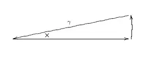

Addendum: A method with residue calculus
Let $t = x^{1/n}$. Then $$\begin{eqnarray*} I &=& \int_0^\infty dx\, \frac{x^{1/n}}{1+x^2} \\ &=& n\int_0^\infty dt\, \frac{t^n}{t^{2n}+1} \end{eqnarray*}$$ Notice the last integral has no cuts for integral $n$. The residues are at the roots of $t^{2n}+1=0$. Consider the pie-shaped contour with one edge along the positive real axis, another edge along the line $e^{i\pi/n}t$ with $t$ real and positive, and the "crust" at infinity.
$\hspace{4.5cm}$pie-shaped contour
There is one residue in the contour at $t_0 = e^{i\pi/(2n)}$. The integral along the real axis is just $I$. The integral along the other edge of the pie is $$\begin{eqnarray*} I' &=& n\int_\gamma dz\,\frac{z^n}{z^{2n}+1} \\ &=& n \int_\infty^0 dt e^{i\pi/n} \frac{t^n e^{i\pi}}{t^{2n}+1} \\ &=& -e^{i(n+1)\pi/n} I. \end{eqnarray*}$$ The integral along the crust goes like $1/R^{2n-1}$ as the radius of the pie goes to infinity, and so vanishes in the limit. Therefore, $$\begin{eqnarray*} I + I' &=& 2\pi i \,\mathrm{Res}_{t=t_0}\, \frac{t^n}{t^{2n}+1} \\ &=& 2\pi i \frac{t_0^n}{2n t_0^{2n-1}}. \end{eqnarray*}$$ Using this and the formula for $I'$ in terms of $I$ above we find $$I = \frac{\pi}{2} \sec \frac{\pi}{2n},$$ as before.

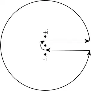

Another Contour Integration:
Let's consider the integral for arbitrary $\alpha\in(-1,1)$: $$ \int_0^\infty\frac{z^\alpha}{1+z^2}\,\mathrm{d}z $$ We will use the contour $\gamma$ shown exaggerated below. The path actually hugs the positive real axis on both sides, tightly circles the origin in a clockwise semicircle, and then circles the complex plane counter-clockwise at an arbitrarily large distance.
$\hspace{4.5cm}$enter image description here
The integrals along the curves vanish as the semicircle gets smaller and the circle gets bigger. The integral just above the real axis is the integral we wish to compute and the integral just below the real axis is $-e^{2\pi i\alpha}$ times the integral we wish to compute ($\mathrm{d}z$ is reversed and $z^\alpha$ is multiplied by $e^{2\pi i\alpha}$).
$\gamma$ circles the singularities at $i$ and $-i$ in a counter-clockwise direction.
Therefore, $$ \begin{array}{lll} \color{#C00000}{2\pi i\,\mathrm{Res}_{z=i}\left(\frac{z^\alpha}{1+z^2}\right)} &\color{#00A000}{+2\pi i\,\mathrm{Res}_{z=-i}\left(\frac{z^\alpha}{1+z^2}\right)} &=\color{#0000FF}{(1-e^{2\pi i\alpha})}\int_0^\infty\frac{z^\alpha}{1+z^2}\,\mathrm{d}z\\ \color{#C00000}{\pi e^{\frac\pi2i\alpha}} &\color{#00A000}{-\pi e^{\frac{3\pi}{2}i\alpha}} &=\color{#0000FF}{(1-e^{2\pi i\alpha})}\int_0^\infty\frac{z^\alpha}{1+z^2}\,\mathrm{d}z\\ &\pi\sin\left({\frac\pi2\alpha}\right) &=\sin\left(\pi\alpha\right)\int_0^\infty\frac{z^\alpha}{1+z^2}\,\mathrm{d}z\\ &\frac\pi2\sec\left(\frac\pi2\alpha\right) &=\int_0^\infty\frac{z^\alpha}{1+z^2}\,\mathrm{d}z \end{array} $$ In particular, if we set $\alpha=\dfrac1n$, we get the same result as above.
