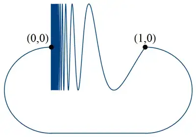

Your primary claim is false, even you require that $C$ be compact. Consider the Warsaw curve:
It is the closure of the graph of $\sin(1/x)$ for $x\in[\pi,\infty)$, together with a simple arc joining $(1,0)$ and $(0,0)$. This separates the plane, but it does not contain a loop that also separates the plane.
Of course, you are looking for the image of a map $\gamma:\mathbb R\to C$ to separate the plane, not just a loop. For that we have to change the example. Start with the closure of the graph of $\sin(1/x)$ for $x\in[\pi,\infty)$, and union that with the closure of the graph of $\sin(1/(x-1))$ for $x\in[\pi,\infty)$, and finally union with a simple arc from $(2,0)$ to $(0,0)$. We can avoid one of the problem points by having $\gamma(t)$ limit to, but never reach that point at $t\to\pm\infty$. But we cannot avoid both points.
