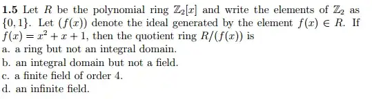

As $f(x)$ is an irreducible over $\mathbb{Z}_2[x]$ so $R/(f)$ is an infinite field. Am I right?
Myshkin
  • 36,898
  • 28
  • 168
  • 346
No the quotient ring is a finite field of order 4. The reason is every element in the quotient ring by the division algorithm is a linear polynomial. There are 2 choices for the coefficient of $\bar{1}$ and 2 choices for the coefficient of $\bar{x}$. Hence 4 choices in total and the quotient is a finite field with 4 elements.
Edit: Bill Dubuque suggested that I add why 1 and 2 are ruled out: The polynomial $f(x) = x^2 + x + 1$ has no roots over $\Bbb{Z}/2\Bbb{Z}$ and being a quadratic is thus irreducible over this field, it follows that the ideal generated by $f(x)$ is maximal from which it follows from this fact proved here that $R/(f(x))$ is a field.
    You omitted perhaps the most important point, namely, saying why it is a field. This is necessary in order to exclude the cases a. and b. – Bill Dubuque Jul 21 '12 at 14:14
  • @BillDubuque It was obvious enough to me to be ommitted. I have added that above. –  Jul 21 '12 at 14:17
    The easiest way to see that is a field is by observing that $x(x+1)=1$. Thus, the three non-zero elements are invertible.... – N. S. Jul 22 '12 at 15:13
