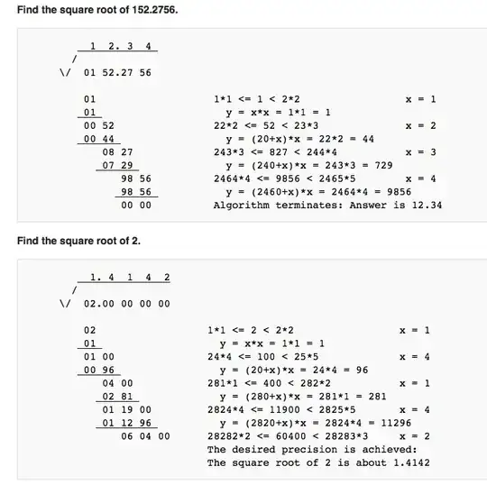

Back in the Olden Days, when I was in school, we learned an algorithm for square-root extraction similar to the long division algorithm. But that topic is long gone: there is no need to learn to do this by hand, since computers and calculators do it quite well.
added
Here is the method.
Examples from Wikipedia:

1I like the algorithm, especially in binary. https://en.wikipedia.org/wiki/Methods_of_computing_square_roots#Binary_numeral_system_.28base_2.29 – Sammy Black Mar 09 '16 at 01:30
I like this. I think I’m older than you, but this was never taught in my school. – Lubin Mar 09 '16 at 14:29
This algorithm provides an approximation, you should address this in your answer – seldon Mar 09 '16 at 18:26
+1: but everybody should be aware of and understand how these classical algorithms (as Knuth calls them in his Art of Computer Programming) work. Yes, calculators and bare computer hardware will do the job - but only to limited precision. You need algorithms to get arbitrary precision - and those algorithms descend from the classical pencil and paper methods. – Rob Arthan Apr 08 '25 at 23:10
