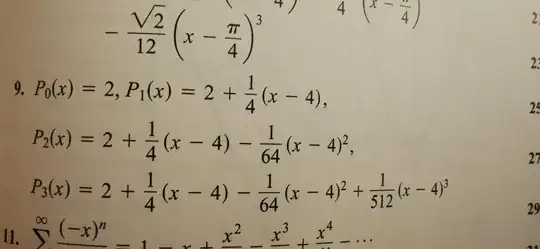

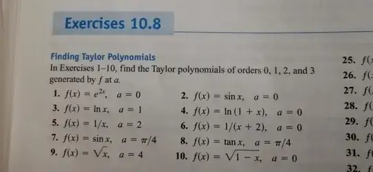

Well, I know this is an old answered post, but referring to the question that all web pages and books doesn't show examples for $\sqrt{x}$, on book, Thomas' Calculus Twelfth Edition on exercises of section 10.8, problem 9 the question is: find the Taylor polynomial of order 0,1,2, and 3 generated by $f$ at $a$ and the exercises are the following
Thomas' Calculus exercises 10.8
And the book also gives the answers, those are the following
Thomas' Calculus answers to section 10.8
I've posted the images of the book in order to show that at least there's one book with the worked exercise.
Internet is a very resourceful place, but good calculus books are a very good option to find lots of exercises and examples that have been worked by experts.
  • but in your book it is specifically stated that we look at taylor series at $a=4$, which is excluded in the OP's question. And exactly that is the problem. So I agree that calculus books are a good source for studying, but the above would not help the OP in a sense that he/she gains more insight in the matter. – Mathbeginner Jan 24 '21 at 10:05
  • Agree, but I was looking to give a more literal answer to the question asked by OP, showing that in fact there is one resource that has an example and not only examples for $\sqrt{x+1}$ are given. On the other hand, to give more insight, we could state: you could find the Taylor series generated by $f(x) = \sqrt{x}$ at $x=a$ as long as $a>0$. But that was the answer given by @Martin R ^_^ – Ricardo Hernandez-Tablas Jan 25 '21 at 16:46
