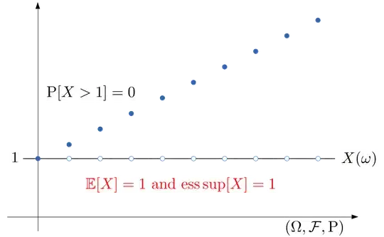

A necessary clarification: A typical example of an essentially bounded function that is not bounded is the following: enter image description here This is given by (here $\Omega=\mathbb{R}$) $$ X(\omega)=\begin{cases} 1, &\text{if} x\in \mathbb{R}\setminus \mathbb{N},\\ x, &\text{otherwise} \end{cases} $$ Indeed, notice that $\mathrm{P}[X>1]=0$.

  • Almost surely bounded, or, essentially bounded, means that there is a $M$ so that $\mathrm{P}[|X|>M]=0$. For instance the function $f(x)=0$ when $x$ is not an integer and $f(n)=n$ for n: integer is essentially bounded (wrt Lebesgue measure), but not surely bounded and it is always finite-valued (in contrast to extended-real-valued functions which may take the value $+\infty$). Continuity is used only in the first part of the answer - I'll update my answer. – Pantelis Sopasakis Feb 14 '16 at 13:58
  • Thank you. Could you please explain why you excluded infinity as $[0,+\infty)$. Doesn't this mean you have taken that the random variable is sure bounded. In my case I only have that $X=+\infty$ with zero probability. What do you mean by continuous random variable, is it in the sense take values in a continuous range? Also how is continuity and non-negativity used here? Finally does this mean the statement is valid only in some special cases and that it is not valid in general? Can you please give a counter example? Apologies, had to make a change so this comment should proceed your comment. – seek Feb 14 '16 at 14:14
  • The way you have stated your questions, $X$ is almost surely bounded. This does not mean that it is finite-valued with probability one. If $X:(\Omega, \mathcal{F}, \mathrm{P})\to \mathbb{R}\cup {+\infty}$ and $\mathrm{P}[X=\infty]=0$, then this doesn't mean that $X$ is essentially bounded and the expectation may be infinite. Would you like me to give a counterexample? – Pantelis Sopasakis Feb 14 '16 at 14:47
  • What I meant by almost surely bounded is $P[\mid X\mid < \infty]=1$, which I belive is equal to $P[\mid X\mid = \infty]=0.$ So as I understand almost sure bounded and this condition are not the same? Could you please explain how they are different? Thank you. – seek Feb 14 '16 at 14:52
  • Yes, these two are not the same. I'll update my answer in a while with a figure. – Pantelis Sopasakis Feb 14 '16 at 14:59
