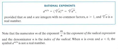

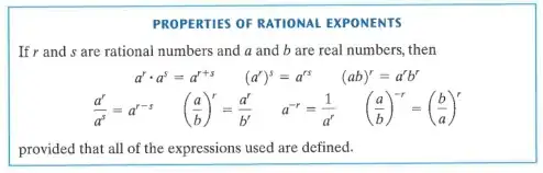

Ratti's definition of rational exponents Ratti's properties of rational exponents
The thing that looks the most suspect in my example above is the 4th equality, $(-1)^{2 \cdot \frac{1}{2}} = ((-1)^2)^\frac{1}{2}$, which seems to violate the spirit of Ratti's definition of rational exponents ("no common factors")... but technically, that translation from rational exponent to radical expression was not used at this point. Rather, we're still only manipulating rational exponents, which seems fully compliant with Ratti's 2nd property: $(a^r)^s = a^{rs}$, where indeed "all of the expressions used are defined". The rational-exponent-to-radical-expression switch (via the rational exponent definition) doesn't actually happen until the 6th equality, $(1)^\frac{1}{2} = \sqrt{1}$, and that seems to undeniably be a true statement. So I'm a bit stumped at exactly where the falsehood lies.
We can find effectively identical definitions in other books. For example, in Sullivan's College Algebra, his definition is (sec. R.8): "If $a$ is a real number and $m$ and $n$ are integers containing no common factors, with $n \ge 2$, then: $a^\frac{m}{n} = \sqrt[n]{a^m} = (\sqrt[n]{a})^m$, provided that $\sqrt[n]{a}$ exists"; and he briefly states that "the Laws of Exponents hold for rational exponents", but all examples are restricted to positive variables only. OpenStax College Algebra does the same (sec. 1.3): "In these cases, the exponent must be a fraction in lowest terms... All of the properties of exponents that we learned for integer exponents also hold for rational exponents."
So what exactly are the restrictions on the Laws of Exponents in the real-number context, with rational exponents? As one example, is there a reason missing from the texts above why $(-1)^{2 \cdot \frac{1}{2}} = ((-1)^2)^\frac{1}{2}$ is a false statement, or is it one of the other equalities that fails?

    Rational exponents are not defined for negative real numbers. So, the paradoxa you describe do not exist. – Björn Friedrich Jan 27 '16 at 06:21
  • @BjörnFriedrich: No, the example that immediately follows Ratti's definition is: $(-8)^\frac{2}{6} = (-8)^\frac{1}{3} = \sqrt[3]{-8} = -2$. – Daniel R. Collins Jan 27 '16 at 06:26
    Your objection to his example is wrong, because he did not say what $a^\frac{m}{n}$ is when $\gcd(m,n) \ne 1$. He only specified what it is when $\gcd(m,n) = 1$, implying that to find the value in general you must first convert it to a form where the rational exponent is expressed in lowest terms. However, as my answer says, his example is wrong for a different reason, namely that his rules are inconsistent due to your example, and that the consistent versions are not enough to specify it but we further need additional definition for $n$-th roots where $n$ is odd. – user21820 Jan 30 '16 at 03:13
  • @user21820: "he did not say what $a^\frac{m}{n} $ is when $gcd(m,n)≠1$". Indeed; making it an undefined expression; I disagree that your implication is necessarily inferred. – Daniel R. Collins Jan 30 '16 at 03:15
  • It is, because the standard interpretation of exponents is that it is an operation, and always you evaluate the operands before you evaluate the operation on them. With this in mind, he states something of the form $P \Rightarrow Q$, and I'm merely using it together with the standard interpretation of binary operations. – user21820 Jan 30 '16 at 03:22
  • @DanielR.Collins The way I interpret it, he has actually defined $a^r$ for all real $a$ and rational $r$. Just because he has restricted to the case $a^{m/n}$ where $(m,n)=1$ doesn't mean that the other cases are undefined - they are covered by rules about canceling factors in a fraction. Any rational number can be written as $m/n$ with $(m,n)=1$, and your example $(-8)^{2/6}=(-8)^{1/3}=\sqrt[3]{-8}=2$ is perfectly valid with Ratti's definition, where the first equality is simply because $\frac26=\frac13$. For that not to be the case would fundamentally break substitutivity of $=$. – Mario Carneiro Jan 30 '16 at 23:52
  • @MarioCarneiro: Well, it can't literally be the case that we've "defined $a^r$ for all real $a$ and rational $r$" here. What about $(-1)^\frac{1}{2}$? Obviously something isn't defined or the restriction at the end of the properties would be empty ("provided that all of the expressions used are defined"), for example. – Daniel R. Collins Jan 31 '16 at 16:45
  • @DanielR.Collins My apologies, I meant to say that he has defined $a^r$ for all real $a$ and rational $r$ for which there is a real solution. The point is that the $(m,n)=1$ restriction does not actually cause holes in the domain of definition, although the additional "$\sqrt[n]a\in\Bbb R$" restriction does, and indeed $(-1)^{2/4}$ and $(-1)^{1/2}$ are not defined by this definition. – Mario Carneiro Jan 31 '16 at 20:16

You have put your finger precisely on the statement that is incorrect.
There are two competing conventions with regard to rational exponents.
The first convention is to define the symbol $a^x$ for $a > 0$ only. The symbol $\sqrt[n]{a}$ is defined for negative values of $a$ so long as $n$ is odd, but according to this convention, one wouldn't write $a^{1/n}$, for instance.
In defining $a^{p/q}$ to be $(\sqrt[q]{a})^p$, the author you quoted chose the fraction $p/q$ to be in lowest form so that the definition would be unambiguous. For example, $a^{10/15}$ is defined to be $(\sqrt[3]{a})^2$. However, it is preferable to define $a^{p/q}$ to be $(\sqrt[q]{a})^p$ in all cases and to prove that this definition is independent of the particular representation chosen for $p/q$; this is what more rigorous books tend to do. That is, you prove that if $p/q = r/s$, then $(\sqrt[q]{a})^p = (\sqrt[s]{a})^r$. There is no mention of lowest form.
The competing convention is to also allow $a^x$ to be defined for all $a \ne 0$ and all rational numbers $x = p/q$ that have at least one representation with an odd denominator. You then prove that $(\sqrt[q]{a})^p$ is independent of the particular representation $p/q$ chosen, so long as the denominator is odd. Thus you can write $a^{3/5} = (\sqrt[5]{a})^3 = (\sqrt[15]{a})^{9} = a^{9/15}$. All of that is fine. However, you cannot write $a^{6/10} = (\sqrt[10]{a})^6$, or even $a^{6/10} = \sqrt[10]{a^6}$. The number $a^{6/10}$ is well-defined, but to write down its definition, you must first select a fraction equivalent to $6/10$ that has an odd denominator, which could be $3/5$ or $9/15$ or something else. For $a^{1/2}$, this can't be done at all, so $a^{1/2}$ is undefined for $a < 0$.
The rules for exponents break down if you start allowing $a < 0$ and exponents that can't be written with an odd denominator. For example, the rule $a^{xy} = (a^x)^y$ is valid, but only so long as $x$ and $y$ are both rational numbers that can be written with an odd denominator. This is not the case if you write $a^1 = (a^2)^{1/2}$, despite the fact that both sides of the equation are defined since $a^2 > 0$.

The 4th equality is indeed suspect, but not for the reason you suggest. It is an application the 2nd property of rational exponents that you list above:
If $r$ and $s$ are rational numbers and $a$ is a real number, then we have: $$(a^r)^s = a^{r\cdot s}$$
provided that all expressions used are defined.
More formally and less ambiguous would be:
$$\forall r,s \in \mathbb{Q}\colon \forall a \in \mathbb{R}\colon [a^r\in \mathbb{R} \land a^s\in \mathbb{R} \implies (a^r)^s=a^{r\cdot s}]$$
This statement makes it clear that we cannot infer $((-1)^2)^\frac{1}{2}=(-1)^{2 \times \frac{1}{2}}$ as in the "paradox" because $(-1)^\frac{1}{2} \notin \mathbb R$, i.e. because $(-1)^\frac{1}{2}$ is not defined.
That both restrictions are necessary can be seen from the fact that we must have $a^{r\cdot s}=a^{s\cdot r}=(a^s)^r=(a^r)^s$. If we had $a^s \notin \mathbb{R}$, we could not make this substitution.
With this in mind, we could restate the rule as follows:
$$\forall r,s \in \mathbb{Q}\colon \forall a \in \mathbb{R}\colon [a^r\in \mathbb{R} \land a^s\in \mathbb{R} \implies a^{r\cdot s}=(a^r)^s=(a^s)^r]$$

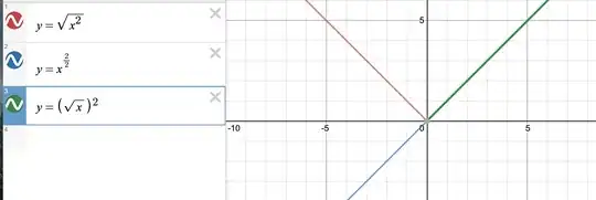

  • The key, based on the images you included, is that $a^{\frac{2}{2}}$ hasn't been defined since 2 definitely shares a common factor with 2. So the "failure" is that $a = a^{\frac{n}{n}}$ is not true in general. In particular, whenever you reduce a rational exponent to radicals, if the fraction isn't in lowest terms, you will end up with an expression like $a^{\frac{n}{n}}$ for some $a$. – Derek Elkins left SE Jan 27 '16 at 06:29

$(a^r)^s=a^{rs}$ can indeed be false for $a<0$, as shown by your example.
You can "rescue" this rule by stating instead "$(a^r)^s=a^{rs}=(a^s)^r$, provided all three expressions are defined". (As the product is commutative, you cannot really distinguish $r$ and $s$.)
    While the "rescue" would be technically correct, stating it thus would be a pedagogical disaster. Saying three expressions are all equal provided "all of the expressions used are defined" is just inviting the error of assuming any two of them are equal provided they are defined. If you need to compare those two expressions, you don't really need to use the third expression at all, so it is not even obvious that "all of the expressions used are defined" is being violated. – Marc van Leeuwen Feb 04 '16 at 05:23

I would currently argue that it's the 2nd equality in the example, $(-1)^1 = (-1)^\frac{2}{2}$, that contains the initial error. It's illegitimate to write $(-1)^\frac{2}{2}$ because that's an undefined expression, although the exact reason depends on which of two common definitions of $a^\frac{m}{n}$ is in use in a given textbook:
  • Some books at the college-algebra level define rational exponents for any real number $a$, but only for rational exponents written in lowest terms (i.e., $m$ and $n$ with no common factors). In this case, $(-1)^\frac{2}{2}$ in invalid because of the common factor in the exponent.
  • Other books, including those at the real analysis level, define rational exponents only for nonnegative real $a$ (i.e., $a \ge 0$), but permit any $m$ and $n$ regardless of common factors. In this case, $(-1)^\frac{2}{2}$ is undefined because of the negative base.
In summary: for $a > 0$, any $(-a)^\frac{n}{n}$ is a meaningless piece of writing. The way that this expression violates the definition of a rational exponent depends on the exact definition in use.
  • I would say instead that the statement you quoted should be corrected by restricting it to cases in which $n$ is even and has no common factors with $m$. – David Jan 27 '16 at 08:26
  • @David: I see why you say that; I spent in inordinate amount of time trying to figure out whether that was implicit in the statement or not. But even if it was, then the expression $(-8)^\frac{2}{6}$ seems to violate the given definition in the first place with its common factors. – Daniel R. Collins Jan 27 '16 at 16:20
  • Edited this answer to make it more concise and cover both oft-seen definitions. I would still argue here that Ratti should delete the example that shows $(-8)^\frac{2}{6} = (-8)^\frac{1}{3} = \sqrt[3]{-8} = -2$. Thanks to David and DerekElkins for helpful answers/comments. – Daniel R. Collins Jan 27 '16 at 16:47

  • I wouldn't take Ratti's quirky definition of rational exponents on $\mathbb{R}$ as, well, definitive. It's just silly that $4^\frac{2}{4}$ would be undefined while $4^\frac{1}{2}=2$. There may be a tendency among writers not to devote a lot of thought to what they may see as "preliminaries" in a textbook. I would be very surprised if Ratti subsequently claimed that something like $4^\frac{2}{4}$ was undefined. – Dan Christensen Jan 31 '16 at 22:56
  • @DanChristensen: Well, I couldn't call this definition "quirky" because it seems to be shared by what looks to be a reasonably wide swath of college algebra textbooks by different authors (e.g., the Sullivan text is a top-10 seller at Amazon in the category). I agree that it seems suspect, but also pretty widespread. – Daniel R. Collins Jan 31 '16 at 23:52
  • I must admit I'm become more convinced that this answer is inadequate, because another question runs into the same paradox without ever writing $a^\frac{n}{n}$, namely: for all $x$: $\sqrt{x^2} = (x^2)^\frac{1}{2} = x^1 = x$. See: http://matheducators.stackexchange.com/questions/10488/student-converted-sqrtx2-and-ended-up-with-just-x-instead-of-x – Daniel R. Collins Feb 01 '16 at 03:30
  • @DanielR.Collins Maybe some off-the-shelf boiler-plate for the "boring" chapter 0 stuff that no-one has ever taken a close look at... until now? It must be tempting for writers. And there is no copyright on definitions and theories. – Dan Christensen Feb 01 '16 at 03:33
  • @DanChristensen: I don't know, that's not how I read it. I picked Ratti because that seems to have the most painstakingly careful development in this vein; takes up 10 pages in the book. Also, I just noticed that Wikipedia also uses the same definition ("Rational powers $u/v$, where $u/v$ is in lowest terms..."), and I assume that page has been beaten on hundreds or thousands of time to get to the current state. – Daniel R. Collins Feb 01 '16 at 03:42
  • @DanielR.Collins The other "paradox" can be resolved in the same way I proposed for yours. You should only be able to infer $(x^2)^{\frac{1}{2} = x^{2\times \frac{1}{2}}$ only if $x^2\in \mathbb{R}$ and $x^\frac{1}{2}\in \mathbb{R}$, that latter being true only if $x\geq 0$. – Dan Christensen Feb 01 '16 at 03:44
  • @DanChristensen: Right, I agree that bolsters the case for that being the best answer. Actually, I used that to provide the answer on the other question. :-) – Daniel R. Collins Feb 01 '16 at 03:45

Graphically the results look very different. Reinforcing the differences.
