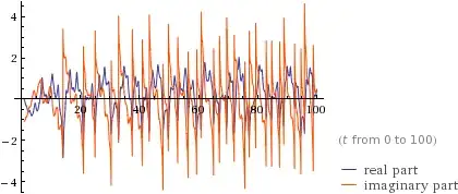

I tried some numerical experiments and found that for $x$ fixed and growing values of $t$ $P_x(t)$ was oscillating 'randomly' without noticeable modification. In fact it seemed scale invariant relatively to $t$ and this for small or large values of $\sigma$ (so that it doesn't behave as $\operatorname{li}$ nor as the error term!).
It could perhaps be interesting to know the algorithm used by Wolfram Alpha to compute the 'prime zeta function' ($P_x(s)$ as $x \to \infty$) in the complex plane since they could evaluate a finite sum combined with an extrapolation (see Neat examples for the case $\sigma =\frac 12$). For real parts of order $0.4$ or more if not on the imaginary line I got this plot of PrimeZetaP[0.4+t*i] :

  • In fact it seemed scale invariant relatively to t and this for small or large values of σ (so that it doesn't behave as li nor as the error term!). That's exactly what I'm after. Why is that and what does that mean? – draks ... Jun 28 '12 at 13:04
  • @draks: (sorry for the delay...) We are adding $e^{-\sigma\log(p)}e^{-i t\log(p)}$ terms. The first is slowly decreasing (for $\sigma \in (0,1)$) while the second is nearly random for large values of $t$ so that all contributions will compensate giving this $t$ scale invariant picture. In fact you should get nearly the same picture if you replace $p$ by an approximation like $i\ln i$ (rounded or not!) even if the phase is replaced by a random number in $(0,2\pi)$. – Raymond Manzoni Jun 30 '12 at 09:09
