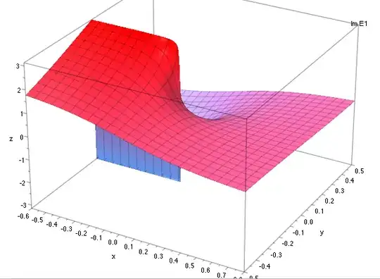

EDIT A simple way to choose between different interpretations is to consider the classical series expansion of $\rm E_1$ as the reference : $$\rm E_1(z)=-\gamma -\ln z -\sum_{n=1}^{\infty} \frac{(-z)^n}{nn!}\ \text{for}\ |{\rm arg}(z)|\lt \pi\ \ \text{(5.1.11)}$$
plot of the imaginary part of $\rm E_1$:
Im E1
The $\rm Ein(z)=\int_0^z \frac{1-e^{-t}}{t} dt\ $ function removes the $-\gamma -\ln z$ part (and the associated 'branch problems') from $\rm E_1(z)$ to get an entire function.

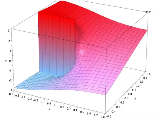

Looking at WolframAlpha and functions.wolfram we may find the $\rm Ei$ formula : $$\rm{Ei}(z)=\gamma +\frac 12 \left(\ln z-\ln\frac 1z\right) +\sum_{n=1}^{\infty} \frac{z^n}{nn!}$$
plot of the imaginary part of $\rm {Ei}$ :
Im Ei

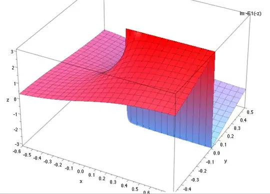

The formula for $\rm{Ei}(z)$ looks similar but is not $-\rm {E_1}(-z)$ as may be seen from the imaginary part of $-\rm {E_1}(-z)$ :
Im -E1(-z)
(to make things even more confusing $\rm{Ei}$ is sometimes defined as $-\rm {E_1}(-z)$ and conversely for example in the excellent book of Lebedev "Special functions and their applications")
The difference comes only from the choice of the cut : for $\rm{Ei}$ and $\rm {E_1}$ the cut was clearly chosen on the negative real axis (with continuity on the other side of course!) so that $-\rm {E_1}(-z)$ will have the cut on the wrong side.
The appropriate definition for $\rm{Ei}$ from $\rm {E_1}$ seems to be : $$ \rm{Ei}=\begin{cases} -\rm {E_1}(-z)+i\pi & \Im(z)>0\ \text{or}\ \Im(z)=0\ \text{and}\ \Re(z)>0\\ -\rm {E_1}(-z)-i\pi & \Im(z)<0\\ -\rm {E_1}(-z) & \Im(z)=0\ \text{and}\ \Re(z)<0\\ \end{cases} $$
