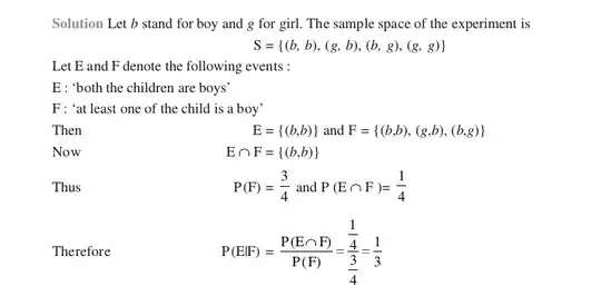

A family has two children. What is the probability that both the children are boys given that at least on of them is a boy?
Solution given in my book is enter image description here
My doubts and my solution
If a family has a child and you are required to find that what is the probability of it to be a boy then your answer will be 1/2.
Now in the present problem it is given that out of two children one is a boy then what is the probability that both are boys.
One child is boy the second child can be a boy or a girl, chance of boy is 1/2.
$P(boy|boy)=\frac{1}{2}$
What I mean is that there are two possible outcomes after we have a boy, it can be a boy or a girl out of this boy is a favorable outcome and so we have 1/2.
Request
Please don't mark this problem as duplicate of this problem or of this problem because my logics are different.

  • "Please don't mark this problem as duplicate because my logics are different." In what way? It sounds like exactly the same argument to me and the answers found there are directly applicable here as well. Your book even gave you a clear solution which appeals directly to the definitions. – JMoravitz Jan 10 '16 at 05:18
You would be correct if $F$ was "the eldest child was a boy", or such information which gives order.   Then you could evaluate the probability that the other child is also a boy the way you suggest.
However the actual event is "at least one child is a boy" and that is not the same thing.   That does not specify which of the two children might be a boy; only that both are not girls.   There's one way both could be boys, and two ways one could be a girl, and these three ways are equally probable so...
There are two possible outcomes, but they are not equally likely.
Graham Kemp
  • 133,231
Always keep in mind that when you solve for a conditional probability, make sure you are using $\frac{P(\text{successful})}{P(\text{total})}.$ You're total ways here is NOT $2$, since there are actually $3$ ways to get at least one boy: BB, BG, and GB. Only one of these is "successful," namely, BB. Since each of the total $3$ ways is equally likely, the correct probability is $\boxed{\frac{1}{3}}.$

You know one of them is a boy but you don't know which one. There are four equally likely possibilities. One is a boy and the other is a boy. One is a boy and the other is a girl. One is a girl and the other is a boy. One is a girl and the other is a girl.
The last one is ruled up. So we are left with 3 equally likely situations. One is a boy and the other is a boy. One is a boy and the other is a girl. One is a girl and the other is a boy.
One situation is 2 boys. Two situations are 1 girl and 1 boy.
So the probability of 2 boys is 1/3. The probability of 1 boy and 1 girl is 2/3.
