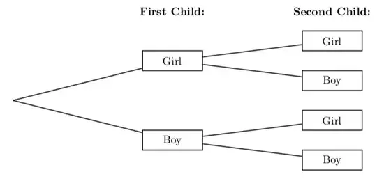

In a family with 2 children there are four possibilities:
1) the first child is a boy and the second child is a boy (bb)
2) the first child is a boy and the second child is a girl (bg)
3) the first child is a girl and the second child is a boy (gb)
4) the first child is a girl and the second child is a girl (gg)
Since we are given that at least one child is a girl there are three possibilities: bg, gb, or gg. Out of those three possibilities the only one with two girls is gg. Hence the probability is $\frac{1}{3}$.

I think that the reason that these puzzles are so often confusing is that they rely on the limitations of the English language rather than on any mathematical difficulties. Of course this is not unique to English, and I think you should be able to find similar similar puzzles in pretty much any natural language.
Here is an example that brings out the difficulty more clearly. First, consider the following similar puzzle:
  • A family has two children, Robin and Lindsay. Lindsay is a girl. What is the probability that both children are girls?
In elementary probability class, they teach you to answer this by making a table of the four options
  Robin    Lindsay
  B        B
* B        G
  G        B
* G        G
The starred rows are the ones where Lindsay is a girl, and we compute from them that the chance that both children are girls is 1/2.
Now consider this puzzle
  • A family has two children, Robin and Lindsay. At least one of them is a girl. What is the probability that both children are girls?
The elementary probability method gives the following table, and a probability of 1/3. The difference is that we gain one more row, compared to the previous puzzle.
  Robin    Lindsay
  B        B
* B        G
* G        B
* G        G
After looking at these, you can see that the difficulty of the original puzzle comes because, in English, "one of the children" can mean several different things:

I am late to the party and there are already several excellent answers to this question, but I think that it is worth adding an answer in order to introduce the idea of probability trees, which are a nice way of visualizing these kinds of conditional probabilities.
In this particular tree, every branch is equiprobable, and a terminal node represents one of the many possible events. From the probability tree, it can be observed that if we know absolutely nothing about a family other than the fact that there are two children, then there are four equiprobable outcomes.
However, if it is known that at least one of the children is a girl, then the event represented by the bottom branch can't happen. Of the remaining three equiprobable events, only one corresponds to the event that there are two girls. Therefore if it is known that a family has two children and it is further known that one of those children is a girl, then the probability that the family has two girls is $1/3$.
I think that the answer is going to be 1/3
As the ways in which your neighbor can have children are as follow:
(where B= Boy; G= Girl)
BB, GG, BG, GB where BB is not possible as one of them is a girl. So the probability of the other child being a G is GG out of the sample space= {GG, BG, GB}
I know some of you might argue that BG and GB are similar things but we don’t know whether the Sister is the elder one or the smaller one. So, it’s gonna work like that.
