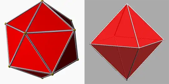

How many different ways can octahedron be inscribed in icosahedron so that all vertices of octahedron are selected vertices of icosahedron?
octahedrons in icosahedron
Can it even be done? There are 4 edges in the middle of octahedron. If I put one of them on an edge in icosahedron, it doesn't seem to me like 2 vertices (of the "middle square") would be touching anything. Is my imagination wrong? Why?

According to this page the answer is no, you can't inscribe an octahedron in an icosahedron so the vertices coincide. You can do it, however, to make the faces coincide.
If group theory doesn't worry you, the wikipedia page on icosahedral symmetry has information about the symmetry subgroups of the icosahedron, and confirms that you can inscribe tetrahedra and cubes in icosahedra so the vertices coincide.
