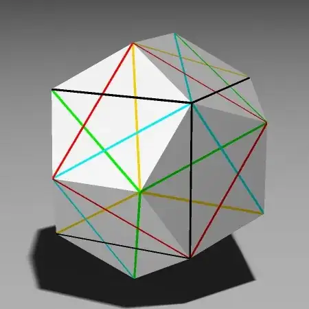

You can do this by considering the dodecahedron, which is dual to the icosahedron and hence has the same group of symmetries.
There are five cubes that fit inside a dodecahedron in such a way that the rotational symmetries permute these cubes with $3$-cycles.
But $3$-cycles in $\mathcal{S}_{5}$ generate $\mathcal{A}_{5}$.
I hope that gives you some strong clues :)
