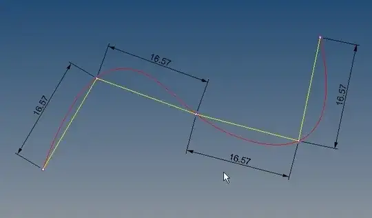

I'm trying to figure out a generic way of determining a series of points on a Bézier curve where all the points are the same distance from their neighboring points. By distance I mean direct distance between the points not distance along the curve. See the image below
alt text
I've written a program that will solve this in an iterative fashion, but I'm wondering if there is a direct solution I could use.
My program starts by defining a circle of some initial radius (R) centered on the start point of the curve. It then intersects this circle with the curve to find the second point , which is R distance away from the start point). It then continues along the curve in this way finding points until it reaches the end of the curve. In most cases the distance between the last intersection point and the end point of the curve will not equal to R. The program then uses that difference to calculate a new value of R to try, and repeats the process.

  • Yes for a given bezier curve I'm looking for the distance that would hit the end of the curve. Or in other words I want to find the X number of points on the curve that include the start point and end point and where all the points are the same direct distance from their neighbors. – Eric Anastas Dec 30 '10 at 20:27

    @I.J.Kennedy I work for an architect. We commonly want to created curved surfaces out of flat panels, but also want all the panels to be the same size. – Eric Anastas Feb 28 '13 at 20:42
So you want the algorithm to "evenly divide" some given Bézier curve into a sequence of n points, such that traveling along the Bézier curve you hit each point in the same order, and such that the direct Euclidean distance from each point to the next point (the chord distance, not the arc distance along the Bézier curve) is the same?
I suspect that you might converge on the desired points a little faster if you pick n "t" values along the curve, and nudge all of them on every iteration -- rather than trying to fix one and going on to the next, and then throwing them all away and starting over every time you pick a new R value.
Say, for example, you want to divide the curve up into n = 100 points. The first point is going to stay fixed at $t_0$=0 and the last point is going to stay fixed at $t_{100}$=1. I'd probably start out at equally spaced t values, $t_0=0; t_1=1/100; t_2=2/100; ...; t_{99}=99/100; t_{100} = 1.$
At each iteration, calculate the distances between neighboring points, then nudge 98 of the t values (being careful not to cross them) to make the distances more equal, sooner or later converging on practically equal distances.
