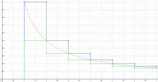

From the figure, you can see that the area under the blue-curve is bounded below by the area under the red-curve from $1$ to $\infty$.
The blue-curve takes the value $\frac1{k}$ over an interval $[k,k+1)$
The red-curve is given by $f(x) = \frac1{x}$ where $x \in [1,\infty)$
The green-curve takes the value $\frac1{k+1}$ over an interval $[k,k+1)$
The area under the blue-curve represents the sum $\displaystyle \sum_{k=1}^{n} \frac1{k}$ while the area under the red-curve is given by the integral $\displaystyle \int_{1}^{n+1} \frac{dx}{x}$ while the area under the blue-curve represents the sum $\displaystyle \sum_{k=1}^{n} \frac1{k+1}$
Hence, we get $\displaystyle \sum_{k=1}^{n} \frac1{k} > \displaystyle \int_{1}^{n+1} \frac{dx}{x} = \log(n+1)$
$\log(n+1)$ diverges as $n \rightarrow \infty$ and hence $$\lim_{n \rightarrow \infty} \displaystyle \sum_{k=1}^{n} \frac1{k} = + \infty$$
By a similar argument, by comparing the areas under the red curve and the green curve, we get $$\displaystyle \sum_{k=1}^{n} \frac1{k+1} < \displaystyle \int_{1}^{n+1} \frac{dx}{x} = \log(n+1)$$ and hence we can bound $\displaystyle \sum_{k=1}^{n} \frac1{k}$ from above by $1 + \log(n+1)$
Hence, $\forall n$, we have $$\log(n+1) < \displaystyle \sum_{k=1}^{n} \frac1{k} < 1 + \log(n+1)$$
Hence, we get $0 < \displaystyle \sum_{k=1}^{n} \frac1{k} - \log(n+1) < 1$, $\forall n$
Hence, if $a_n = \displaystyle \sum_{k=1}^{n} \frac1{k} - \log(n+1)$ we have that $a_n$ is a monotonically increasing sequence and is bounded.
Hence, $\displaystyle \lim_{n \rightarrow \infty} a_n$ exists. This limit is denoted by $\gamma$ and is called the Euler-Mascheroni constant.
It is not had to show that $\gamma \in (0.5,0.6)$ by looking at the difference in the area of these graphs and summing up the area of these approximate triangles.
