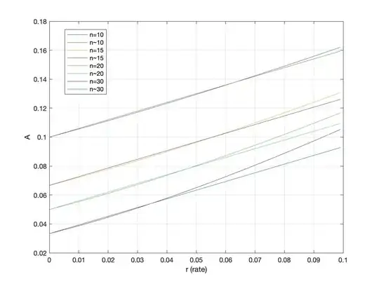

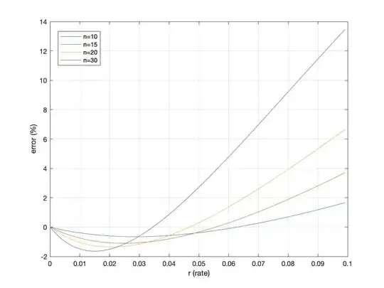

Here is my 1st order simple equation:
$$A = P (1/n + 0.6r)$$ when $r n < 1$
Assume your variable i = my variable r
Take a $1M loan example with 4% interest over 15 years, (r * n = 0.6 OR r * n < 1).
Interest loan equation = $7,495 per month (annually compounding)
1st order approx. = $7,556 per month
error = + 0.8%, not bad!
If you use month compounding, the error does get a little higher.
Here is some comparison results of A for a range of r and n values: A vs r
Here is error function: error vs r
Your boy seems very smart and you also seem like a maths wiz. I don't know why my approximation works (especially where the 0.6 constant come from?!?) - I am just an engineer and realized for low r*n values, the curves are reasonably linear and can be linearly interpolated by my simple equation
