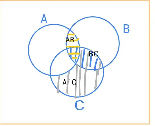

Though this has already some good answer, I know an interesting way to look at boolean expression with less than 4 elements(for greater than 3 it becomes messy ),it might be helpful for any future user struggling with a similar problem.
Imagine them as Venn diagrams, draw their intersection using the given expression, after this most of the time question becomes trivial.
You can easily see/confirm A'C +AB covers the colored region completely.
(ignore my drawing skills) ignore my drawing skills
