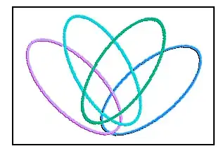

This page gives a few examples of Venn diagrams for $4$ sets. Some examples:
alt text alt text
Thinking about it for a little, it is impossible to partition the plane into the $16$ segments required for a complete $4$-set Venn diagram using only circles as we could do for $<4$ sets. Yet it is doable with ellipses or rectangles, so we don't require non-convex shapes as Edwards uses.
So what properties of a shape determine its suitability for $n$-set Venn diagrams? Specifically, why are circles not good enough for the case $n=4$?

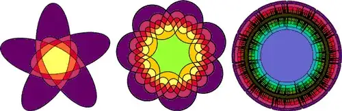

To illustrate further, consider some of the complex shapes used for n=5, n=7 and n=11 (from Wolfram Mathworld):
Venn diagrams for n=5, 7 and 11
The structure of these shapes is chosen such that they can intersect with each-other in as many different ways as required to produce the number of unique regions required for a given n.
