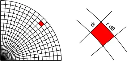

Of course, if you break $\mathbb{R}^2$ into a polar grid
$\hspace{3.5cm}$polar grid
the small slightly curved rectangles have area $r\,\mathrm{d}\theta\,\mathrm{d}r$.
However, it seems that you are interested in looking at $$ \begin{align} \mathrm{d}y\,\mathrm{d}x &=(\sin(\theta)\,\mathrm{d}r+r\cos(\theta)\,\mathrm{d}\theta)(\cos(\theta)\,\mathrm{d}r-r\sin(\theta)\,\mathrm{d}\theta)\\ &=r\,\mathrm{d}\theta\,\mathrm{d}r \end{align} $$ and why the $\mathrm{d}r^2$ and $\mathrm{d}\theta^2$ terms disappear and the $\mathrm{d}r\,\mathrm{d}\theta$ and $\mathrm{d}\theta\,\mathrm{d}r$ have different signs.

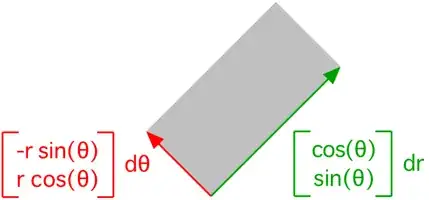

Let's start with $$ \begin{align} \mathrm{d}x&=\cos(\theta)\,\mathrm{d}r-r\sin(\theta)\,\mathrm{d}\theta\\ \mathrm{d}y&=\sin(\theta)\,\mathrm{d}r+r\cos(\theta)\,\mathrm{d}\theta \end{align} $$ rewritten as $$ \begin{bmatrix}\mathrm{d}x\\\mathrm{d}y\end{bmatrix} =\begin{bmatrix}\cos(\theta)\\\sin(\theta)\end{bmatrix}\mathrm{d}r +\begin{bmatrix}-r\sin(\theta)\\r\cos(\theta)\end{bmatrix}\mathrm{d}\theta $$ Therefore, the displacements $\color{green}{\mathrm{d}r}$ and $\color{red}{\mathrm{d}\theta}$ get mapped to $\color{green}{\begin{bmatrix}\cos(\theta)\\\sin(\theta)\end{bmatrix}\mathrm{d}r}$ and $\color{red}{\begin{bmatrix}-r\sin(\theta)\\r\cos(\theta)\end{bmatrix}\mathrm{d}\theta}$ in $\mathbb{R}^2$:
$\hspace{3cm}$parallelogram
where the area in gray is given by $\color{green}{\begin{bmatrix}\cos(\theta)\\\sin(\theta)\end{bmatrix}\mathrm{d}r}\times\color{red}{\begin{bmatrix}-r\sin(\theta)\\r\cos(\theta)\end{bmatrix}\mathrm{d}\theta}=r\,\mathrm{d}r\,\mathrm{d}\theta$.
The fact that the cross product is involved is the reason that the $\mathrm{d}r^2$ and $\mathrm{d}\theta^2$ terms disappear and the $\mathrm{d}r\,\mathrm{d}\theta$ and $\mathrm{d}\theta\,\mathrm{d}r$ have different signs. This, and its $n$-dimensional analogs, are why we use wedge products and differential forms when changing variables.
