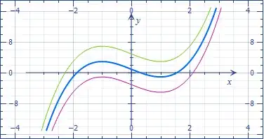

Hint:
Let us consider the depressed form, $$y=x^3+px+q.$$
By canceling its derivative $$y'=3x^2+p,$$ we have two extrema (maximum then minimum) at $\mp\sqrt{-\dfrac p3}$, provided $p$ is negative.
The values of the function at the extrema are $$\pm\sqrt{-\frac{p^3}{27}}\mp p\sqrt{-\dfrac p3}+q=\pm2\sqrt{-\dfrac{p^3}{27}}+q.$$
When the value of the maximum is positive and that of the minimum is negative, there are three real roots, otherwise one:
$$-\sqrt{{-\frac{p^3}{27}}}+\frac q2>0\text{ and }\sqrt{{-\frac{p^3}{27}}}+\frac q2<0\iff \frac{p^3}{27}+\frac{q^2}4>0.$$ enter image description here
This is how the discriminant appears.
  • Sorry I dont get it. // for this thing "-\sqrt{{-\frac{p^3}{27}}}+\frac q2>0\land \sqrt{{-\frac{p^3}{27}}}+\frac q2<0\iff \frac{p^3}{27}+\frac{q^2}4>0.", what is the ^ doing there ? from wiki, I found that the discriminant for cubic is 18abcd - 4b^3d+ b^2c^2-4ac^3-27a^2d^2.... I really dont understand where it came from... sorry – Tommy Lassa Jul 23 '15 at 17:26
  • I said depressed form. –  Jul 23 '15 at 18:10
  • Hi, why does p have to be negative? Cant t be a complex number? – Tommy Lassa Jul 27 '15 at 15:40
  • For real extrema and real roots, no. –  Jul 27 '15 at 16:01
  • I am sorry. In that case, when we have two extrema, the cubic function will be symmetrical? I mean, if the value of function at the extrema are +/- (square root(-p/3)), the function will be symmetrical? – Tommy Lassa Jul 28 '15 at 10:22
  • A cubic is always symmetrical around its inflection point. Always. –  Jul 28 '15 at 10:34
  • Hi, so when p is positive, the cubic must have 1 real and 1 pair complex conjugate? – Tommy Lassa Jul 28 '15 at 11:14
  • how about when the cubic has 2 double and 1 distinct root? In that case, the discriminant will equal to 0? But I dont see where it comes from... sorry – Tommy Lassa Jul 28 '15 at 20:04
  • Try and understand the picture. –  Jul 28 '15 at 20:37
  • I really tried. I didnt get how you jump from saying max is positive min is negative to the discriminant equation. ( the last part. ) as when the discriminant is positive there will be 1 real solution, which the max is not positive and min is not negative. So they dont match. I dont get it. :( – Tommy Lassa Jul 28 '15 at 21:03
  • $$-a<b<a\leftrightarrow b^2>a^2$$ –  Jul 29 '15 at 07:21
