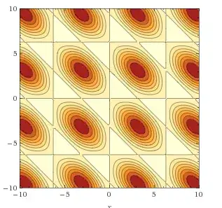

The solution set of $\cos(x) + \cos(y) - \cos(x + y) = 0$ looks like an ellipse. Is it actually an ellipse, and if so, is there a way of writing down its equation (without any trig functions)?

    Level curves close to a local maximum or a local minimum tend to look like ellipses, simply because the level curves of the second-order Taylor polynomial, which approximates the function, are ellipses. (At least "usually", i.e., in the positive or negative definite case, not the semidefinite case). – Hans Lundmark Jun 23 '15 at 20:39

It looks like an ellipse because the isocurves of any smooth surface look like an ellipse in the vicinity of an extremum !
Indeed, by Taylor's development in 2D,
$$f(x,y)=f(a,b)+\frac{\partial f}{\partial x}(x-a)+\frac{\partial f}{\partial y}(y-b)\\ +\frac12\frac{\partial^2 f}{\partial x^2}(x-a)^2+\frac{\partial^2 f}{\partial x\partial y}(x-a)(y-b)+\frac12\frac{\partial^2 f}{\partial y^2}(y-b)^2\cdots$$
This development shows that in the vicinity of an ordinary point, a smooth surface usually behaves like a plane because the linear terms dominate, and isocurves are approximately straight lines.
But when the first derivatives are zero, the next order terms, the quadratic ones, enter into play and the behavior becomes that of a quadric. The isocurve $f(x,y)=F$ is approximately of the form
$$A(x-a)^2+2B(x-a)(y-b)+C(y-b)^2=D,$$ an ellipse centered at $(a,b)$. (Provided that the quadratic form is positive-definite, i.e. not a saddle point.)
The closer you get to the extremum, the more you get an exact ellipse. The effect is more pronounced and the curves more symmetric when the third order derivatives are small.

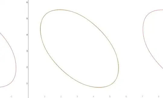

In the case of the given trigonometric function, translating the coordinates to $(\pi,-\pi)$, to bring a maximum at the origin, we get
$$z=\cos(x)+\cos(y)+\cos(x+y).$$
Then the Taylor development up to fourth order yields
$$z\approx 3-x^2-xy-y^2+\frac{x^4}{12}+\frac{x^3y}6+\frac{x^2y^2}4+\frac{xy^3}6+\frac{y^4}{12}.$$

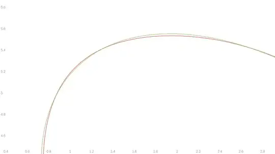

The plot below shows you the isocurve $z=0$ computed with the quadric (brownish) and quartic (pinkish) approximations; the latter is indistinguishable from the true curve, a quasi-ellipse.

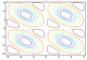

import numpy as np
%matplotlib inline
x = 2*np.pi*np.arange(-1,1,0.01)
y = 2*np.pi*np.arange(-1,1,0.01)
z = np.cos(x[...,None]) + np.cos(y[None,...]) - np.cos(x[...,None]+y[None,...])
plt.contour(x,y,z)
They are definitely not ellipses:
Alternatives plots from Wolfram Alpha. Somehow the level sets must interpolate between the "ellipses" and the "bow-ties".

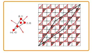

Amoebas and Coamoebas
Using Demoivre identity $\cos \theta + i \sin \theta = e^{i\theta}$ we can instead consider the equation in complex numbers:
$$ e^{ix} + e^{iy} - e^{i(x+y)} = z + w - zw = 1 - (z-1)(w-1) = 0$$
The set of points $(z,w) \in \mathbb{C}^2$ satisfying this equation is not an algebraic variety. The log of the norms are what is known as an amoeba.
$$ \log: (z,w) \mapsto (\log |z|, \log|w|) \hspace{0.25in}\text{for}\hspace{0.25in} (z,w) \in \{ (z,w):z + w - zw\} $$
The angles of the solutions to this equation are known as the coamoeba
$$ \arg: (|z|e^{i\theta},|w|e^{i\phi}) \mapsto (\theta, \phi) \hspace{0.25in}\text{for}\hspace{0.25in} (z,w) \in \{ (z,w):z + w - zw\} $$
See What is an Amoeba in the Notices of the American Mathematical Society. Or the Master's thesis of Masahito Yamazaki Brane Tilings and their Applications

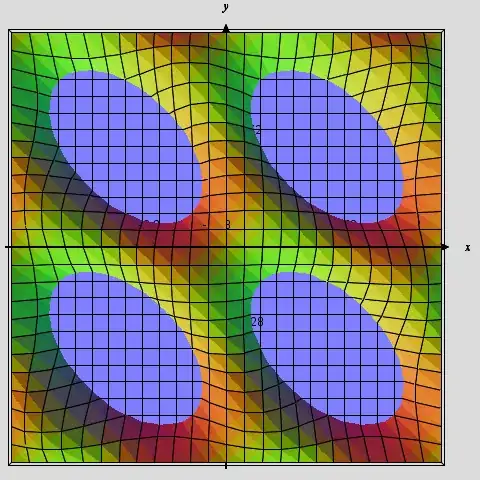

Your equation is not an ellipse, or even a family of ellipses. Ellipses are graphs given by a quadratic relation in $$Ax^2+Bxy+Cy^2+Dx+Ex+F=0.$$ Your equation, using Taylor Expansion (for $k\to\infty$), is $$\sum _{n=0}^k\frac{\left(-1\right)^n\left(x^{2n}+y^{2n}\right)}{\left(2n\right)!}=\sum _{n=0}^k\frac{\left(-1\right)^n\left(x+y\right)^{2n}}{\left(2n\right)!},$$ which is only quadratic for $k=1,$ and incidentally the graph for $k=1$ is not an ellipse but the hyperbola $xy+1=0.$ As a related note, a near duplicate of your graph using an ellipse is $$\left(x-\pi \right)^2+\left(x-\pi \right)\left(y-\pi \right)+\left(y-\pi \right)^2-\sqrt{19}=0.$$ But by inspection we see the curvature of the graphs are not equal. enter image description hereenter image description here
In fact, here is an animation showing the polynomial relations for $k=0$ to $k=20.$
The "ellipses" occur along the lines $y=\pm x.$

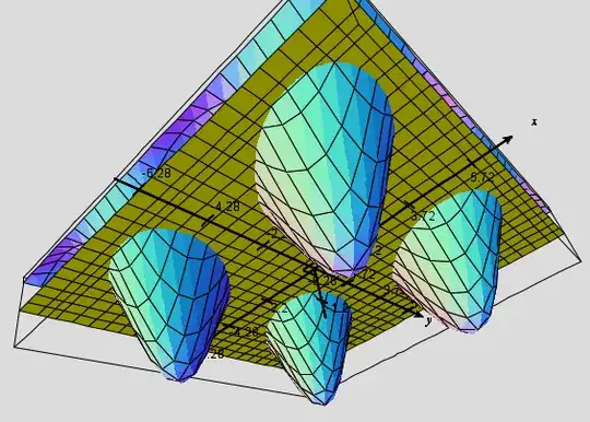

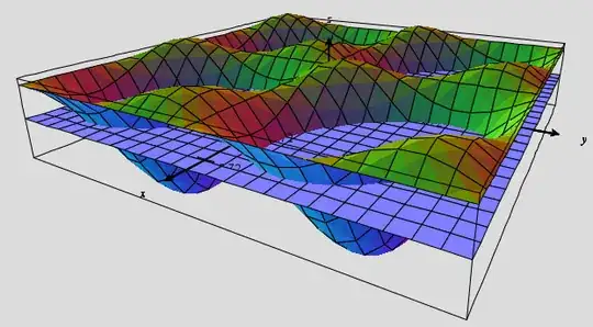

Also, as conjectured my @MathGemini in the above comments, your graph could be an agglomeration of cones in $(x,y,z),$ where $$z=\cos x+\cos y-\cos(x+y).$$ This is not the case, however because the surface you get is one of periodic maxima and minima, which is the expected behavior given by the equation.
cos1
(This is the surface and its intersection with the $xy$ plane viewed from the positive $z-$axis.)
(This is the surface and its intersection with the $xy$ plane viewed from $x>0,y>0,z>0.$)
(This is the surface and its intersection with the $xy$ plane viewed from below the $xy-$plane.)

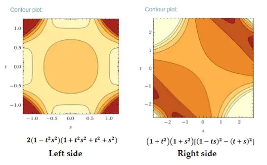

For the record, the substitution $t=\cos x, s=\cos y$ leads to $2st(s+t) + 1 = 2(s^2+t^2+st)$ with $s, t$ ranging over $[-1, 1]$. We now need some algebraic geometer to recognize this equation...

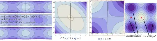

From the exact equation you have given a second degree approximation around its center can lead you to an ellipse, as per the following second degree approximation.
EDIT1:
$ \cos x + \cos y = \pm \cos (x+y) $ , including negative sign if you shift
attention to the hyperboloid side of contour as well.
$ \cos x \approx. 1 - x^2/2 ,\cos y \approx 1 - y^2/2 ,\cos (x+y) \approx 1 - (x+y)^2/2 $ respectively simplify to
$ x^2 + y^2 + x\, y =1 $ and $ x\, y + 1 =0 $ . By taking 3,4,5 number of terms the 'ellipse' or 'hyperbola' can be approximated. So what you now see are a higher order ellipses/hyperbolas.
With respect to the oval center it looks like an ellipse. With respect to a center point of ovals as center you notice that..
the hyperbola look-like profile is ignored as, perhaps people look at the more round profile only. Different viewpoint centers are attached in the last illustration for level plots of $ \cos x + \cos y $.
Ellipse/HyperbolaLikeDiffPerspectives
