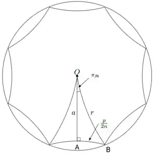

Proof of the given question:
Let $p_n$ be the perimeter of a regular $n$-gon drawn inside of a circle. $a$ is the length of the perpendicular from the origin $O$ to a side of the $n$-gon, $p$ is the sum of the lengths of the sides of the $n$-gon, and $r$ is the radius of the circle and the $n$-gon.
Now as $n → ∞$, the $n$-gon increases to fill the circle. Therefore, we define the circumference $C$ as $$~C = \lim_{n→∞} p~.$$
From the sine formula for $ΔOAB$ , $$\sin\left(\frac{π}{n}\right) = \frac{\sinh(p/2n)}{\sinh(r)}\implies \sinh\left(\frac{p}{2n}\right)=\sinh(r)\cdot \sin\left(\frac{π}{n}\right)\tag1$$
By series expansion $(1)$ gives, $$\frac{p}{2n}~\left[1+\frac{1}{3!}\left(\frac{p}{2n}\right)^2+\frac{1}{5!}\left(\frac{p}{2n}\right)^4+\cdots\right]=\frac{\pi}{n}~\sinh(r)~\left[1-\frac{1}{3!}\left(\frac{\pi}{n}\right)^2+\frac{1}{5!}\left(\frac{\pi}{n}\right)^4-\cdots\right]$$ $$\implies p~\left[1+\frac{1}{3!}\left(\frac{p}{2n}\right)^2+\frac{1}{5!}\left(\frac{p}{2n}\right)^4+\cdots\right]=2\pi~\sinh(r)~\left[1-\frac{1}{3!}\left(\frac{\pi}{n}\right)^2+\frac{1}{5!}\left(\frac{\pi}{n}\right)^4-\cdots\right]$$
Taking limit as $~n \to ∞~$, $$C=\lim_{n\to\infty}p=~2\pi \sinh(r)~$$
Note: Given any right triangle $~\Delta ABC~$, with $~∠C~$ being the right angle, in the hyperbolic plane. Let $a, ~b,$ and $c$ denote the hyperbolic lengths of the corresponding sides. Then $$\sin A =\frac{\sinh a}{\sinh c}\qquad \text{and}\qquad \cos A = \frac{\tanh b}{\tanh c}$$
