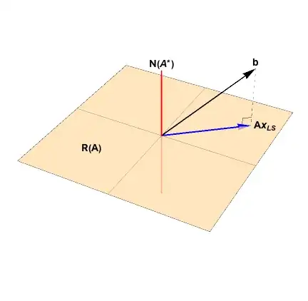

1 Given the general least squares problem, $$ \lVert \mathbf{A} x - b \rVert_{2}^{2} > 0 $$ and the constraint $$ \lVert \mathbf{A} x - b \rVert_{2}^{2} < \lVert b \rVert_{2}^{2} $$ ($b$ is not in the null space), we can decompose the problem as $$ \color{blue}{\mathbf{A}x} = \color{blue}{{b}_{\mathcal{R}\left( \mathbf{A} \right)}} + \color{red} {{b}_{\mathcal{N}\left( \mathbf{A}^{*} \right)}}. $$ This resolves the data vector into its $\color{blue}{range}$ space and $\color{red}{nullspace}$ components. The derivation is shown in How does the SVD solve the least squares problem?
The residual error vector is the component of the data vector which resides in the null space: $$ \color{red}{r\left(x_{LS}\right)} = \color{blue}{\mathbf{A}x} - ( \color{blue}{{b}_{\mathcal{R}\left( \mathbf{A} \right)}} - \color{red} {{b}_{\mathcal{N}\left( \mathbf{A}^{*} \right)}}) = \color{red} {{b}_{\mathcal{N}\left( \mathbf{A}^{*} \right)}} $$
Resolving the data vector into range and null space components.
