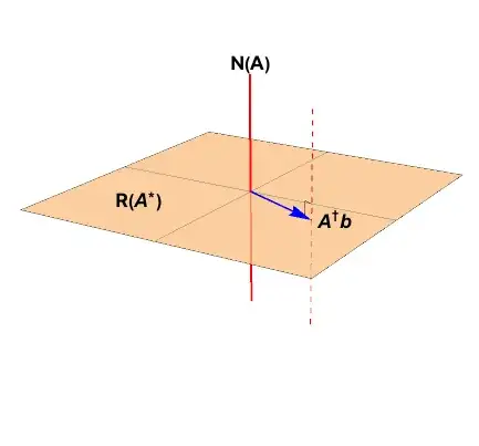

@joriki provides a great answer. This post has a different perspective and should be viewed as a complement his work.
Definitions
The linear system is $$ \mathbf{A} x = b \tag{1} $$ where the system matrix has rank $\rho\le\min\left( m,n \right)$, $ \mathbf{A} \in \mathbb{C}^{m\times n}_{\rho} $ and the data vector $b\in \mathbb{C}^{m}$. For existence, we require that the data vector is not in the null space: $b\notin\color{red}{\mathcal{N}\left( \mathbf{A}^{*}\right)}.$
The least squares solution to $(1)$ is defined as $$ x_{LS} = \left\{ x\in\mathbb{C}^{n} \colon \lVert \mathbf{A} x - b \rVert_{2}^{2} \text{ is minimized} \right\} $$ The least squares minimizers are the affine set given by $$ x_{LS} = \color{blue}{\mathbf{A}^{+} b} + \color{red}{ \left( \mathbf{I}_{n} - \mathbf{A}^{+} \mathbf{A} \right) y}, \quad y \in \mathbb{C}^{n} $$ Coloring indicates membership in $\color{blue}{range}$ or $\color{red}{null}$ space. The least squares minimizers are represented by the dashed $\color{red}{red}$ line below.
solution
Solution of minimum norm
Every vector on the dashed line minimizes the sum of the squares of the residual errors. What are the lengths of these vectors? $$ \lVert x_{LS} \rVert^{2}_{2} = % \lVert \color{blue}{\mathbf{A}^{+} b} + \color{red}{ \left( \mathbf{I}_{n} - \mathbf{A}^{+} \mathbf{A} \right) y} \rVert^{2}_{2} % = \lVert \color{blue}{\mathbf{A}^{+} b} \rVert^{2}_{2} + \lVert \color{red}{\left( \mathbf{I}_{n} - \mathbf{A}^{+} \mathbf{A} \right) y} \rVert^{2}_{2} % $$ Which of these vectors has the shortest length? The case where $y=\mathbf{0}$. The least squares minimizers with minimum length is the vector lying in the range space $\color{blue}{\mathcal{R} \left( \mathbf{A}^{*} \right)}$. This vector is $$ \color{blue}{x_{LS}} = \color{blue}{\mathbf{A}^{+} b} $$
The question about the minimum norm solution reveals a misunderstanding. The pseudoinverse solution $\color{blue}{\mathbf{A}^{+} b}$ does not select the solution of minimum length. It is the solution of minimum length.
