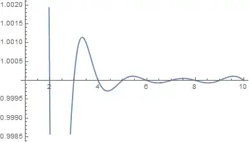

In the (in WP) cited article of A Bennett (1915) for the interpolation to fractional orders (there $n$ here $h$) A.Bennet misses the possibility to take another base $b$ for iterated logarithm and exponentiation, where $b \ne e$ and actually $1<b<e^{1/e}$ where we can iterate infinitely and also have a "regular" method for interpolation to fractional orders/iterates using E. Schröder's method which I've used here. See the screenshot of some paragraph in A. Bennett's short paper:
  • Note that both $t$ and $b$ are close to 1. In dynamics it is helpful to locate the fixed points of a system. Let $A(x,y,1)=x+y$ and $A(x,y,2)=x*y$. $A(1,1,n)=1$ except when $n=1$. So for small values of $z$ we might expect the dynamics of $A(1+z,1+z,n)$ to be relatively simple. –  May 08 '15 at 18:34
  • @Daniel: yes; in the first example I work with $t=1.01$ which is also the (lower) fixpoint of $b=t^{1/t} \approx 1.019$ and attracting for the exponentiation, because the upper fixpoint is above $10$ which is the limit of the the intended multiplication table. In the second example I think the value for the base is not so important and might go up to $b=4$ or $b=10$ (although I didn't really look at it) – Gottfried Helms May 09 '15 at 06:46

First identify a fixed point for an iterated function which can be a hyperoperator, $f^n(x)$. Now $f$ is a "horizontal or intra-hyperoperator function." And $g$ is a "vertical or inter-hyperoperator function".
Consider that $g(1\uparrow^x1)=(1\uparrow^{x+1}1)$ with $(1\uparrow^\infty1) = 1$ as a fixed point.
Mathematica 12 Code
$g[1]=1\uparrow1, g[2]=1\uparrow^21, g[3]=1\uparrow^31$
g[x_] := Interpolation[{2, 1, 1, 1, 1, 1, 1, 1, 1, 1, 1, 1, 1}, InterpolationOrder -> 12][x]
Plot[g[x], {x, 1, 10}, AxesOrigin -> {1, 1}]
Hyperoperators at 1.0
Note the period two nature of the function $g$ and the convergence to the fixed point $(1\uparrow^\infty1) = 1$. So $(1\uparrow^x1)$ extends the Ackermann function to real values.
Let $1\le a<2$. I conjecture that $a\rightarrow\infty\rightarrow\infty=a$
