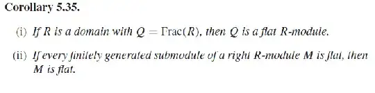

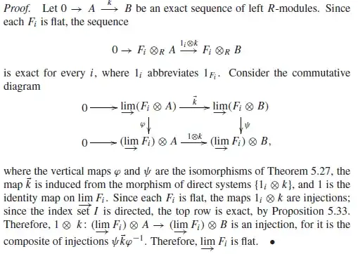

Rotman in the book "An Introduction to Homological Algebra" has (Corollary 5.35 ii):

    Are we to rest assured the proof does not use localization? – rschwieb Apr 30 '15 at 18:42
    @rschwieb: The proof of prop 5.34 certainly does not use localization. However the only way I know how to express the fraction field of a domain as a direct limit is over the localizations at various nonzero elements. – RghtHndSd Apr 30 '15 at 18:46
